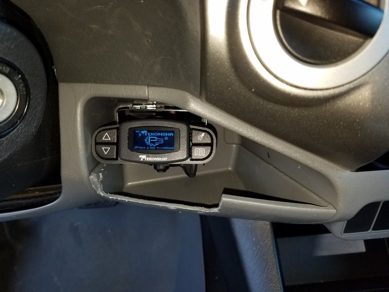

    Your trd off road has the plug. Mine was tucked up under the dash completely concealed by electrical tape. Took a good minute to find it.
    This is where I put mine.
