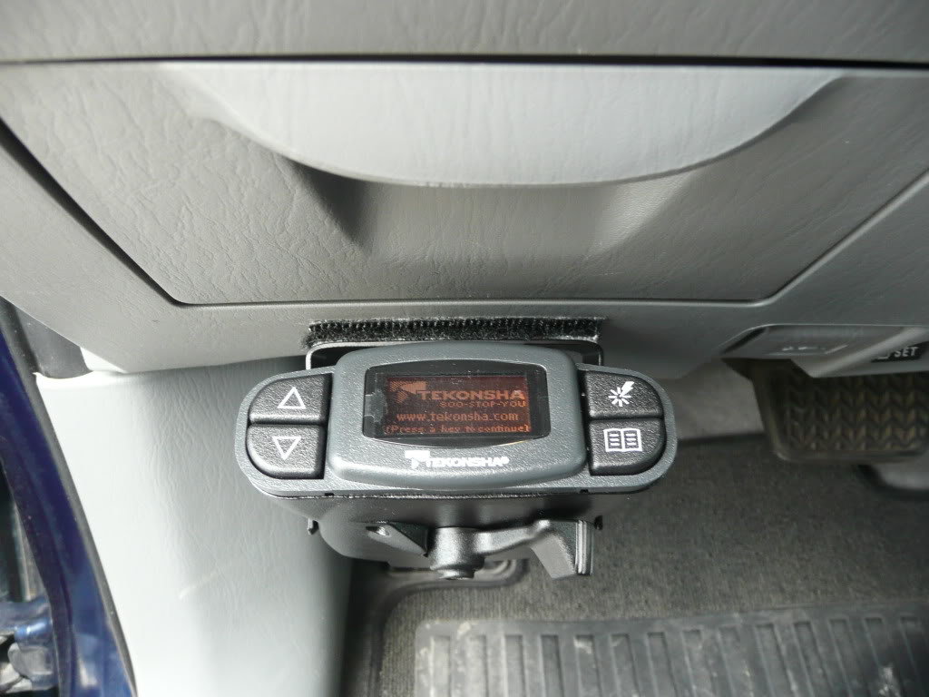

    Which Brake controller do you guys suggest?
    I am towing a Jayco X19H.
    I am thinking of a Tekonsha P3. Do I need a special harness, or will the one from the factory be fine? One more ???: the P3 does not have to be installed level, correct?
    Thanks everybody!

    You can't go wrong with the Tekonsha. I have the Prodigy and it works great. Just make sure you get the Toyota harness and it's just plug and play.
    It doesn't have to be level but it does have to face you somewhat

    Tekonsha P3 is what I use. It works great and easy install.

    Ok, now I am even more confused:
    - I thought the Tekonsha P3 was the Prodigy, like in "Tekonsha Prodigy P3", I read that several times.
    - so I do need a separate cable harness?
    Thanks a lot!

    Etrailer.com Tekonsha P-3 with harness (3040-P). Good price. Quick delivery. Plug and play.

    That is a nice trailer sechsgang! I am towing a Starcraft 176 RB, which is the cousin of your trailer (both are made by Jayco and are an identical floor plan).
    I am running a Tekonsha Prodigy P3. I used the factory pigtail that was provided with the truck. No complaints here and I saved myself $10! I picked mine up from RV Wholesalers for $133.
    The P3 controller has a 180 degree vertical plane operating range. It can be mounted between -90 degrees ,straight down, and 90 degrees, straight up

    Thanks Dan! I am set to replace my time based controller with the P3!
