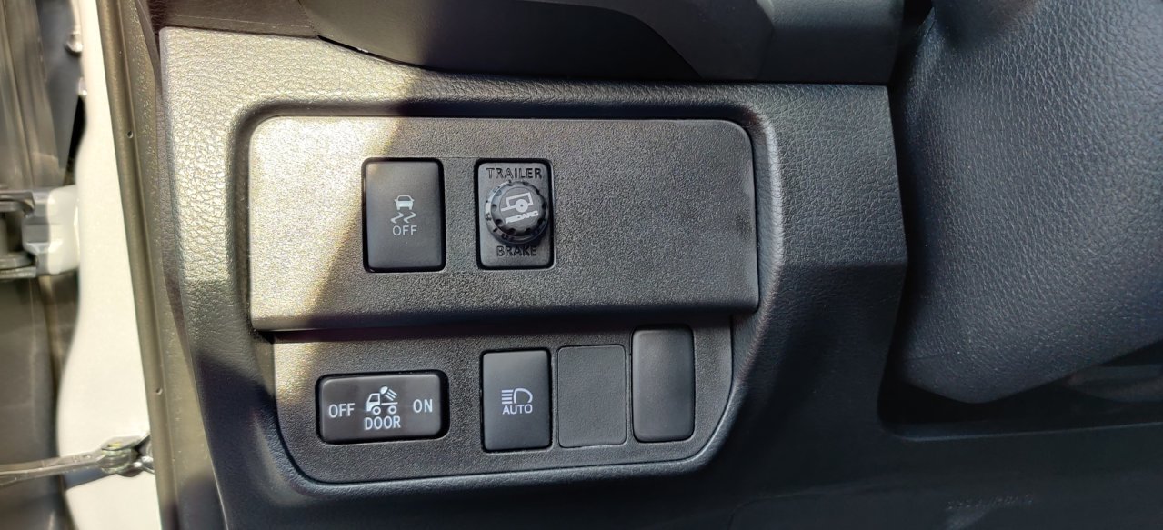

    I’m sure the wiring harness is long enough to mount the controller under the drivers side dash and the switch in the dash below the heater controls. I put mine on the left side since I had an open blank there but there was easily enough extra cable to reach. If you haven’t bought/received it yet I would do some mock up first, I think you will be surprised.

    I agree with some of the other memebers; RedArc is the easiest and works great. I installed the Liberty for less than $150 including the unit, switch insert, and wiring. Looks OEM and takes the place of an unused blank.

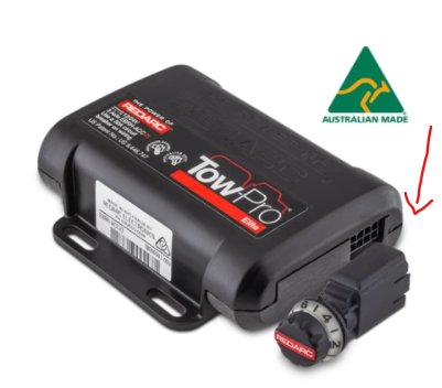

    [QUOTE="Taco_mike73, The cable to the remote control is exactly like ethernet cable so you could just buy a longer one if needed to mount the remote. You should be able to get one at a local computer store or order one from Monoprice.[/QUOTE]
    Hey Mike!
    The Tow Pro V2 came with a rj45 cable from box to knob, the new V3 will have an automotive connector that is a bit different just a heads up!
    As you'll see in this photo on the side of the box, no worries though the cable will still be plenty long for most applications.
