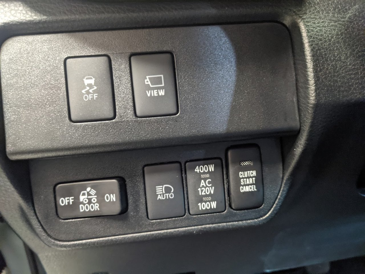

    The bummer I'm facing is I don't have any blanks left, just a big open spot where I'd have to drill a hole. I don't like drilling holes in $50k things.

    Same boat, waiting for Meso to open up orders for that custom panel insert.

    Meso or maybe you have an open spot in under the climate control.

    All mine under climate are filled. I installed the 2Lo mod so I could back trailers up hills. The only thing I don't much care for on the MT is that reverse is geared super high. Do people really need to go this fast backwards?

    Looks like you are going to get a Meso customs panel. I have many extra spaces in my truck but then mine is an SR5. I do not have as many options and buttons as the TRD and Pro have.

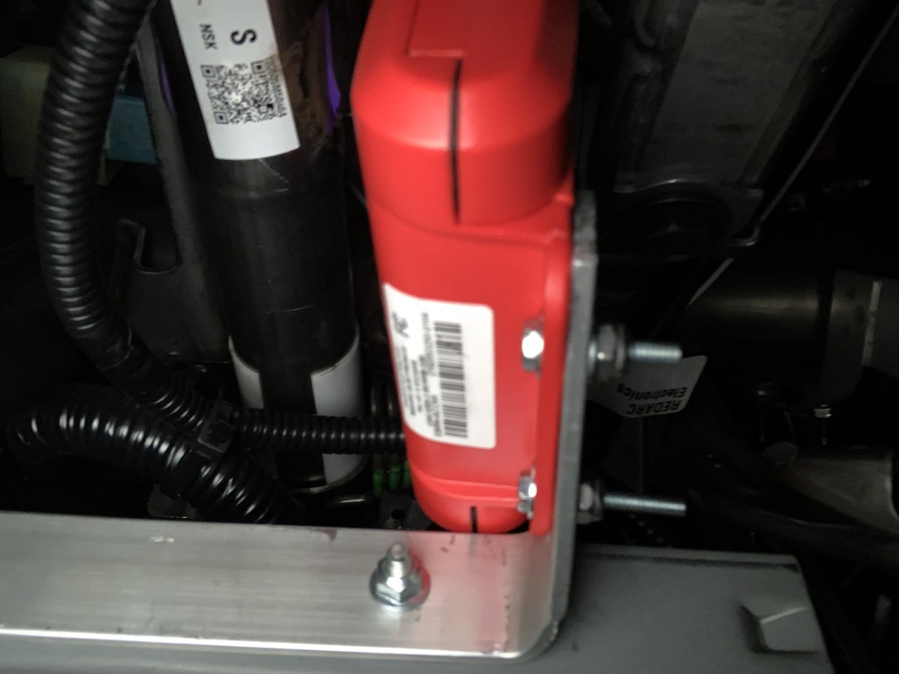

    Installed my Liberty today. Used the plug and play harness from Etrailer and the switch blank the goes by the power inverter.
    made a small mounting plate the went onto the back of the two studs that I am guessing hold the airbag in place. Very rigid mount so should not impact performance.
    on a side note I was worried it wasn’t working because it didn’t light up. It only lights up when a trailer is connected. To test you can push the knob and a blue light comes on.

  15. Mar 23, 2021 at 9:31 PM
    #55
    REDARC_Ryan
    REDARC_Ryan Well-Known Member
    Mar 5, 2021
    #358309
    53
    Michigan
    2021 Tacoma TRD Off-Road
    OME BP-51's, CBI Covert Bumper, Rhino Rack Roof Rack, Mits Alloy Tray & Canopy, Alu Cab RTT, Falken Wildpeak A/T, RIGID Lighting
    That is correct, no lights unless plugged in.

    Used the same spot. Bent a piece of aluminum in a vice and then used a drill and rotary tool to make the mount. I also had the same concern with mine about not working. Should’ve read the entire manual first. Haha
