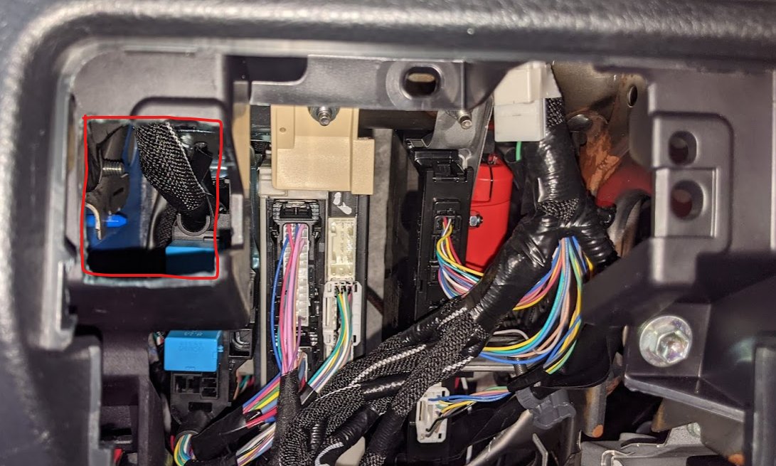

    When using the studs holding the driver side knee air bag to attach the brake controller, is there any concern that this might compromise the airbag in any way?

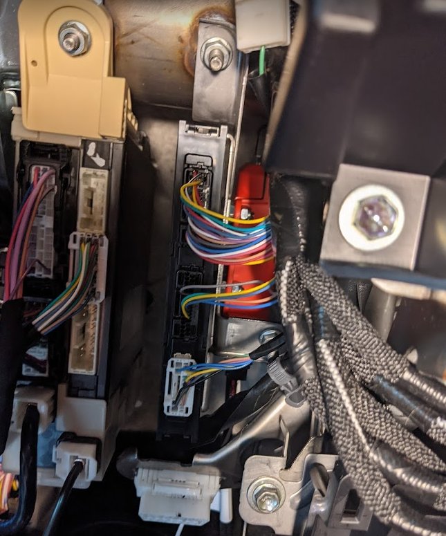

    The studs behind the dash on my 2021 weren’t available. There was a module mounted vertically to one of them. It may be for the blind spot/rear cross traffic options installed on my truck.

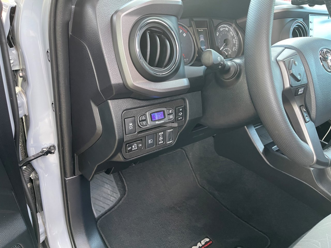

    I ended up sticking my Elite on the left side behind the cubby. Tight fit, but gorilla double sided tape should keep it in place pretty well.

    2020 OR DCSB AT 4WD
    This?

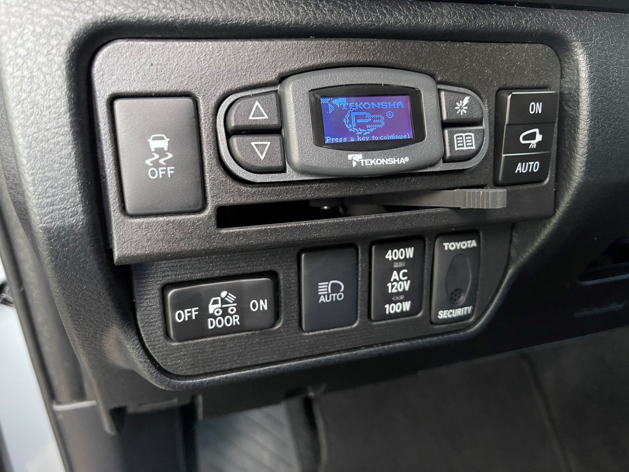

    Just like @Bertw192, I got the Meso custom cubby to fit my Tekonsha P3.

    2020 OR DCSB AT 4WD
    Not OEM then. That location is unused except for that module pictured, the ECU for the OEM glass break sensor.
    Edit: After installing mine, the left stud has the smart key ECU.

    I went with Redarc so any empty Toyota blank switch spot is suitable, I just didn't have any spaces. Those STL's you found are a really good option, plenty of print labs available. I do have to say, the Tekonsha with the MESO panel is clean.

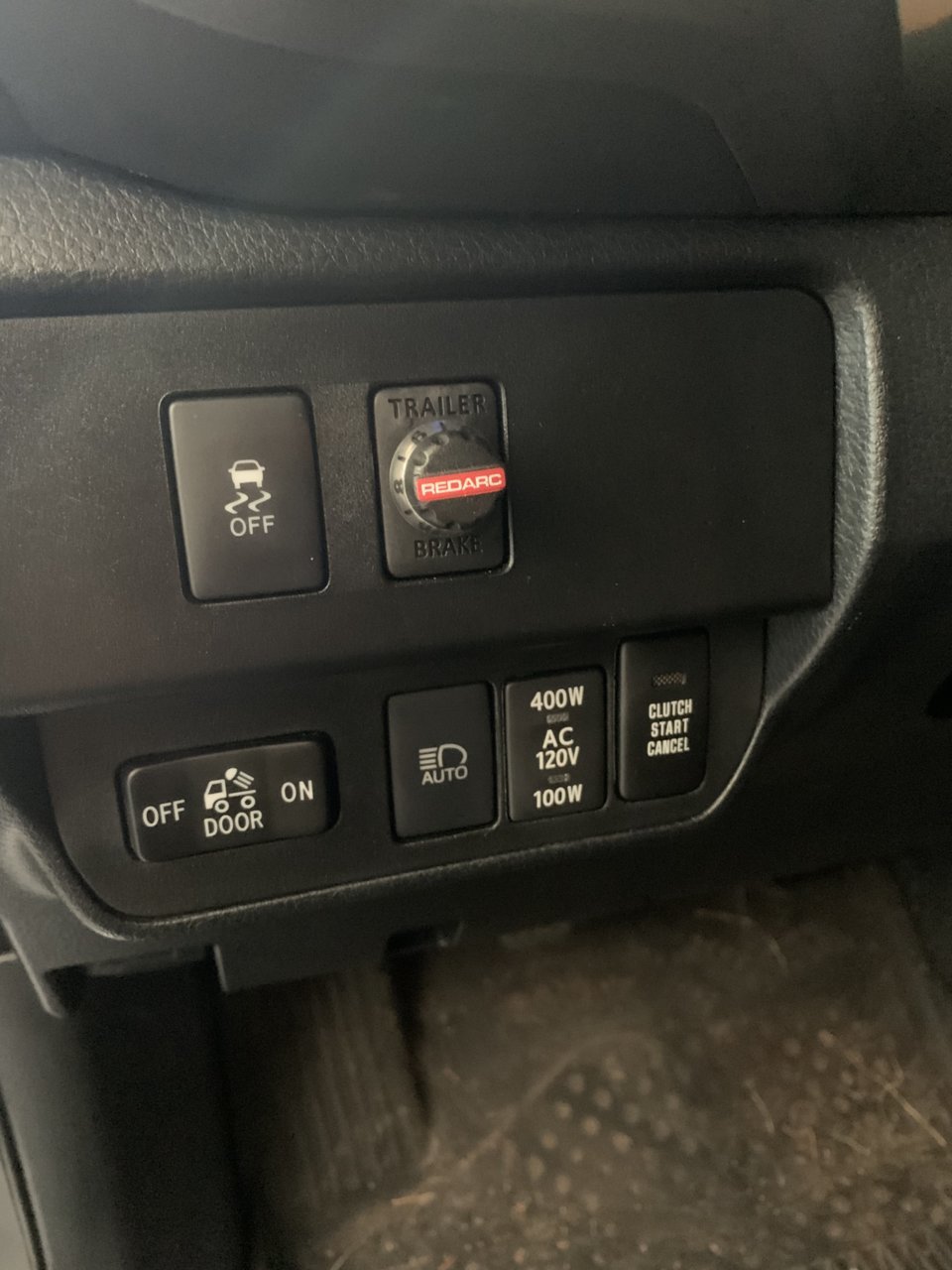

    I bought a Redarc to tow my camper. It works great and looks factory!

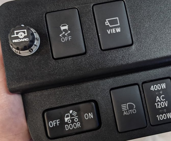

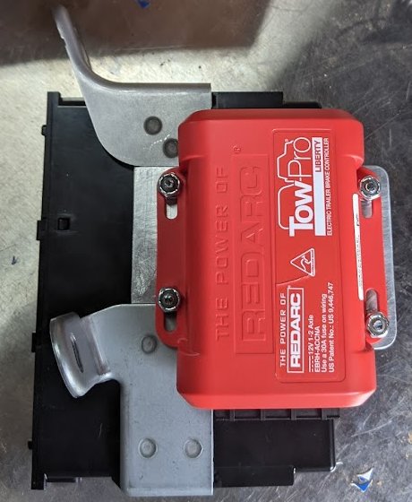

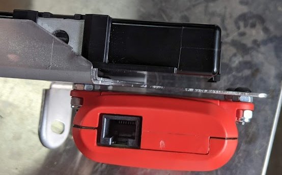

    Redarc Install
    Main unit mounted on the smart key ECU bracket with fabricated extension. Intended to use rivnuts but there wasn't enough clearance. Not ideal, but ended up using 8-32 screws as standoffs.

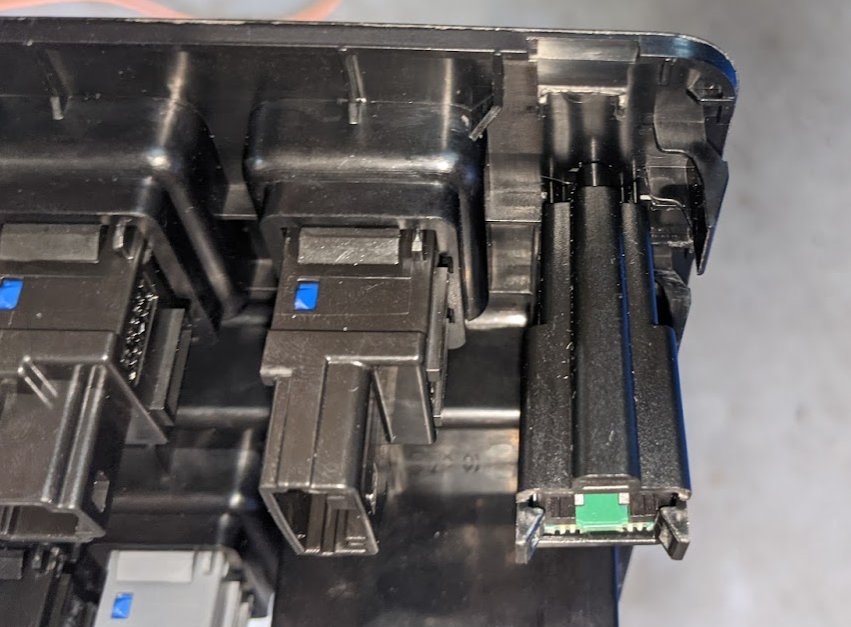

    Left side switch plate knob. Choose this location as the most visible and easily reached for manual control.
    Small amount of webbing removed from the back of the panel to fit the knob.
    Unused cubby mounting point that had to be removed to clear the depth of the knob.
    Wiring to factory trailer brake connector and harness grounding

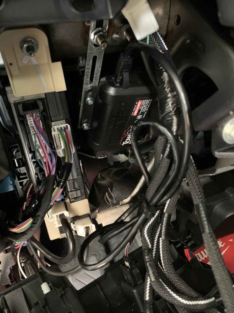

    this is a good picture of what I was talking about in regards to something taking up the studs

    Yeah, smart key ecu as it turns out. I wasn't expecting that to be there either. Every picture I had seen there was unused space.

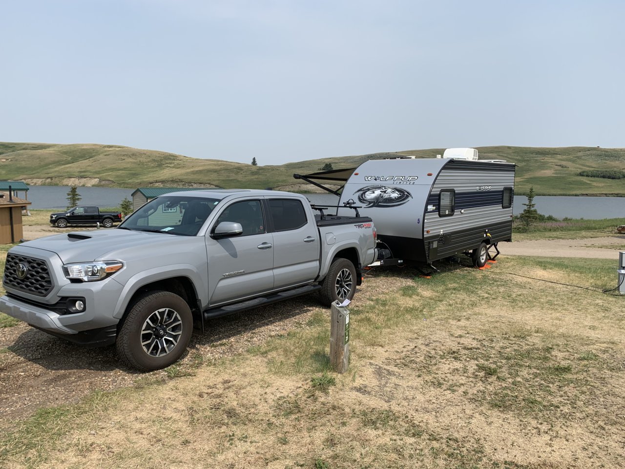

    Thumbs up for Redarc. I have the Elite for towing a 3200 lb Wolf Pup 16TS. There were a couple of empty threaded studs behind the switch panel on my 2020 6MT that worked perfectly with the Redarc mounting kit. And a convenient ground lug on the kick panel side. The Redarc works really well and very easy to adjust on the fly.
    And the customer service from Redarc has been fantastic.
