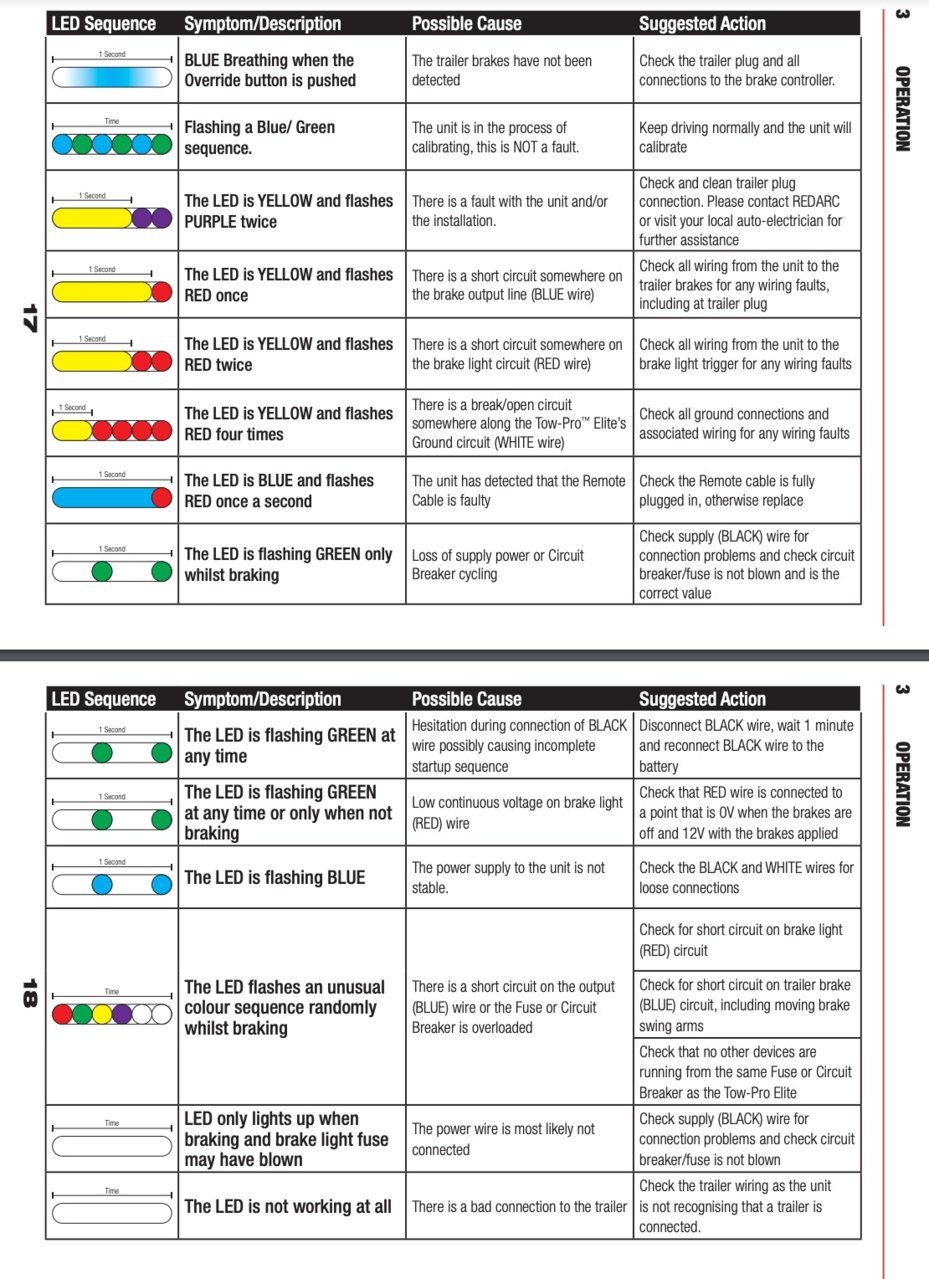

    If im not mistaken, i also got that code and it freaked me out as it was the first time even towing anything. what i remember finding was that it was applying brake while still learning the load. When I would get off the brake it would change to the "Learning" flashing code.
    After the learning was done the "Applying Brake" color was constant and the Blue standby was also constant

    Thanks for the response. I'm towing a dump trailer and the weight will vary based on the load. Maybe that's why mine keeps doing it.
    Interesting the redarc article doesn't mention this color sequence.

    Did you check pages 17 and 18 of the user's manual? If you are getting a combination of colors that are not mentioned here I would reach out to Redarc customer service here in the states.

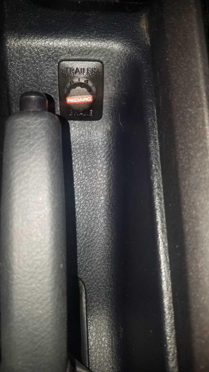

    Thanks for the writeup and the great picture. I will be doing this pretty soon.

    Thanks, I have a 2019 TRD and adding a trailer brake controller. You post was a perfect solution.

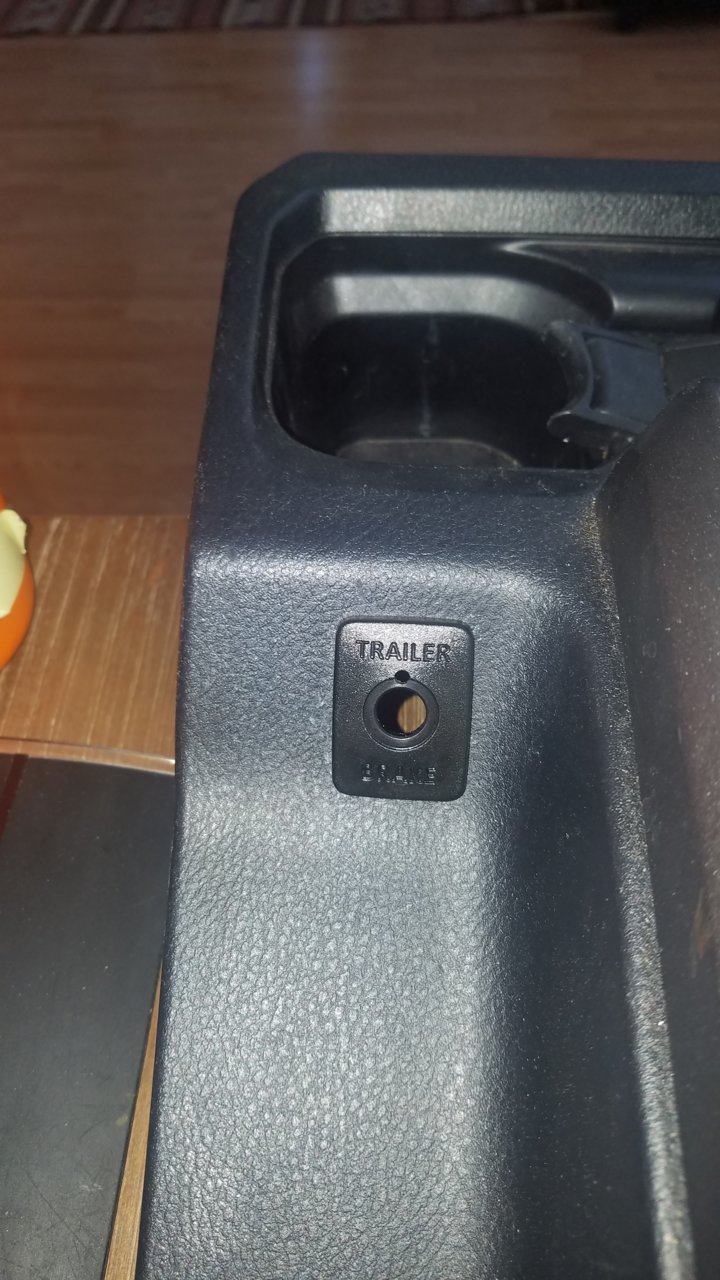

    Does anyone have pictures of how to get that switch panel out in order to wire the controller and replace the blank? I'm sure I can figure it out but don't want to break anything. Thanks!

    I don't remember the exact videos, but YouTube, they will do a better job than I can.

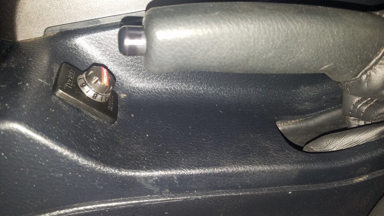

    Pretty clean install!

    Thank you! If I encounter any oh s*** moments, I can now break the trailer at my fingertips without having to fumble towards the dashboard to find the brake controller. :thumbsup:
