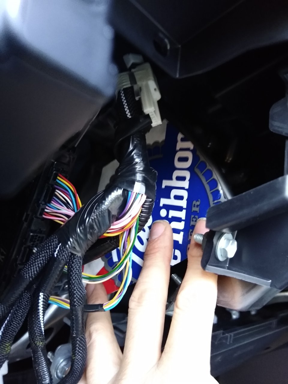

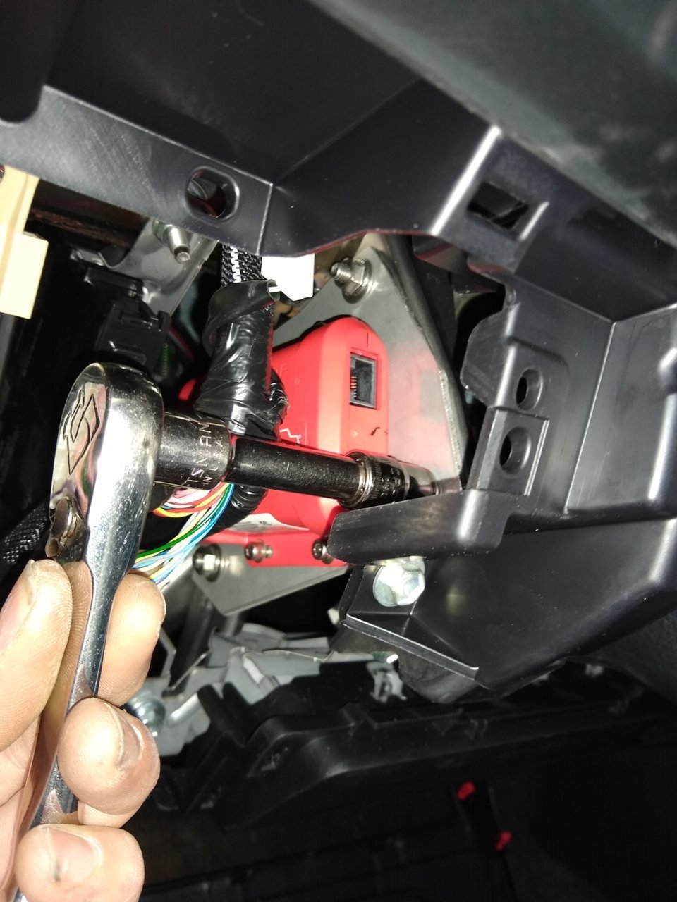

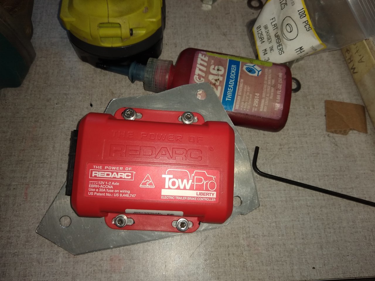

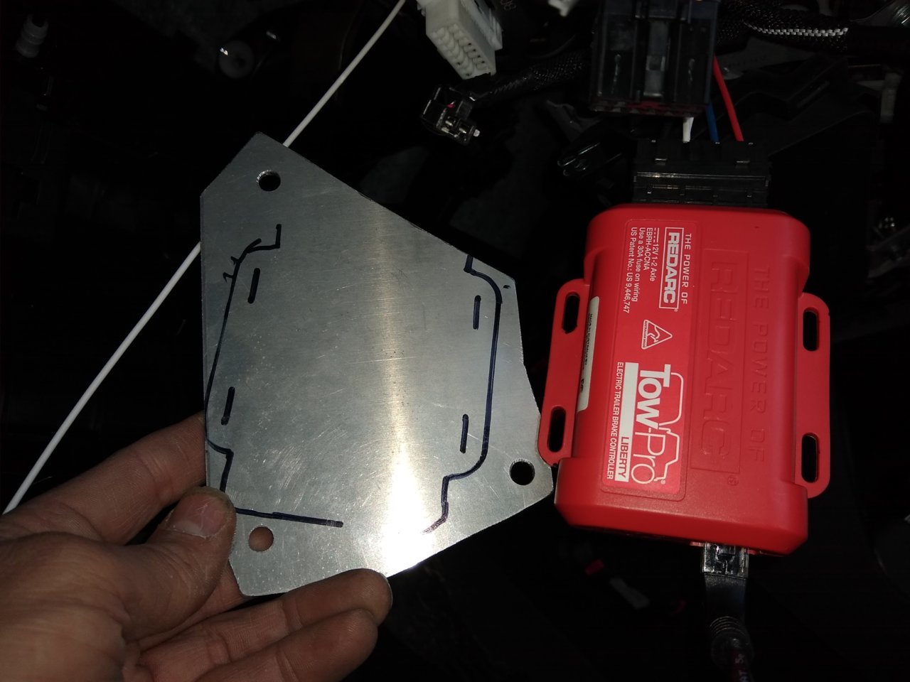

    1. Make template for the spot against steering column brace using beer case cardboard while drinking beer.
    2. Make plate.
    3. Mounted to plate w/ four M4 screws.
    4. Bolt with three M6 bolts/washers/nuts. Solid as the steering column itself.
    5. Done. Only 2 casualties in the process.
