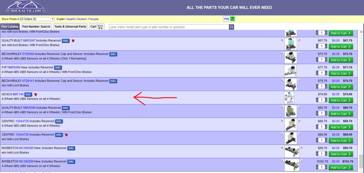

    Thanks, that's really helpful. Rock auto (for the 1996 year model) lists options for both ABS and NON-ABS master cylinders. Mine does have a wire / plug on the side of the reservoir....so I was assuming maybe that is the ABS version?? Here's a link and screenshot from the Rock Auto website. From the pics (and description)....it looks like what I need. Do ya'll agree??

    The wire and plug are the fluid level sensor (the Brake light on the dash will come on with there is low fluid). Please re-read my description of what an ABS truck is equipped with. Or better yet, enter your vin into Toyota's vin decoder / build specs, and see if it was factory installed. It's unlikely that someone would have added it down the line.

    Ya the reservoir sensor is a level sensor. Easiest way i can think of to check is to check the knuckle for a wire running to the wheel bearing/knuckle area. If you have a wire you have abs. No wire and no abs
