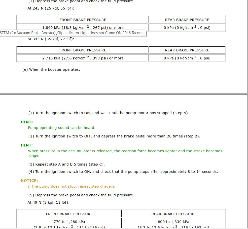

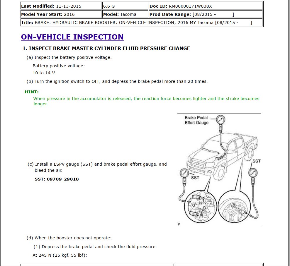

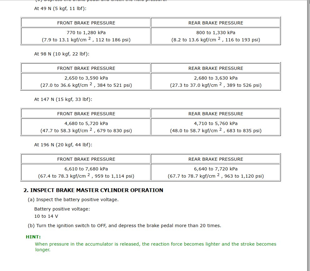

  8. Oct 4, 2021 at 5:54 PM
    #48
    crazysccrmd
    crazysccrmd Well-Known Member
    Mar 17, 2016
    #181592
    9,217
    Alaska
    Aprilia Tuareg 660
    Not exactly but you can do the basics. Key off, pump the pedal 20 times until the stroke is longer and pedal softer, key on, electronic booster pump should run to recharge which will also firm up the pedal. The pump noise is pretty obvious, especially with the hood open.
  9. Oct 4, 2021 at 5:56 PM
    #49
    GrundleJuice
    GrundleJuice Well-Known Member
    Mar 15, 2015
    #150931
    2,346
    Michigan
    2016 TRD Bro
    [S]Un-Molested[/S] Lightly Molested
    agreed. Think he kind of did that already, but without the excess pumping to bleed off accumulator. Confirming power to the pump would be a good place to start if it's accessible.

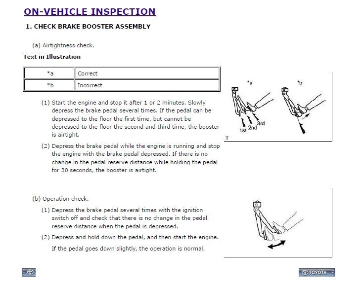

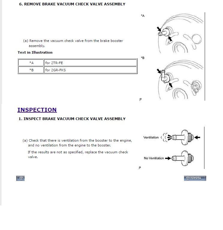

    I know there was a Recall on some vacuum assisted ones. The electrical ones are their own monster.

    ShimStack
    ShimStack Well-Known Member
    Mar 11, 2012
    #74701
    1,648
    Ben
    NC
    '91 Truggy, '98 Project, '16 DC OR M/T Locked F/R
    No, the OR has a hydroboost (hydraulic boost) system. This uses pressurized fluid to amplify the braking force you apply at the pedal. There is an electric motor, pump, and accumulator as part of this hydraulic boost system.
