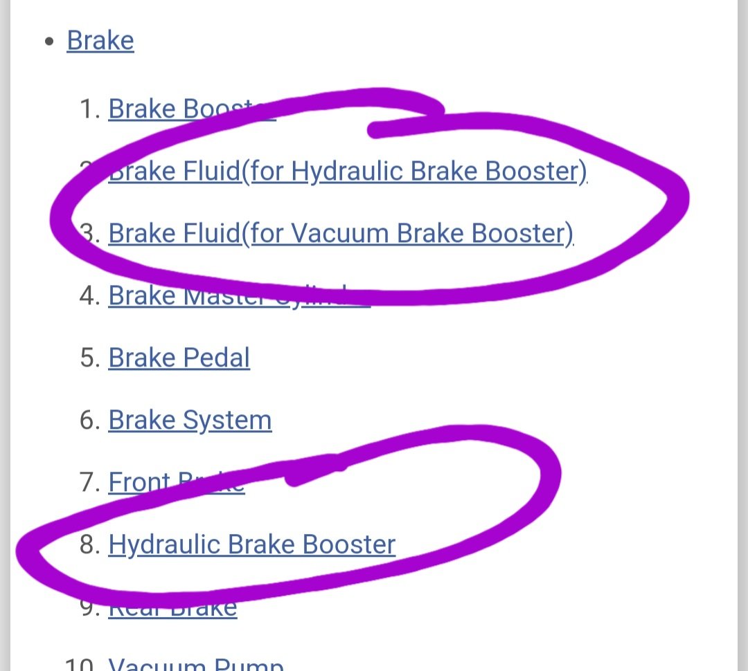

    The distinction is what is actually doing the work, i.e. what is the actuator. Both cases you mention are hydraulic boost systems because hydraulic force is applying the "boosted" portion of the effort. What runs the pump to pressurize the fluid or what is the control signal is a description of the system but doesn't change that they're fundamentally hydraulic boost systems.
    An electrical boost system would use an electrical actuator or motor to directly do the work. There are true electrical steering assist systems now as opposed to hydraulic power steering assist systems and these use electric motor actuators to amplify steering effort making them true electrical boost.
    SR-71A and Skydvrr like this.

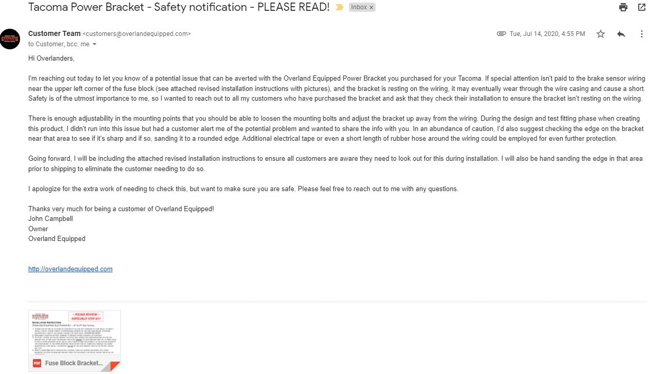

    This is it meaning you have that same bracket and the wire is cut? Or just the same symptoms/lights.

  17. Oct 4, 2021 at 10:13 PM
    #77
    Paps
    Paps [OP] Active Member
    Oct 4, 2021
    #378835
    42
    same bracket, same wire cut.
    roguegs, Kev250R, crazysccrmd and 2 others like this.
  18. Oct 4, 2021 at 10:16 PM
    #78
    Paps
    Oct 4, 2021
    #378835
    42
    trying to find a fix. Hopefully it's a simple wire fix and not major damage to a computer or such.

    You should contact the owners of the company, and let them know. They sent an email PSA letting owners know about this issue on July 14th, 2020 (attached). @Mr.Pink Taco is somewhat active on here. He should chime in.
    I personally protected the wire with a rubber fuel line. This thread makes me want to go check it out. GL!

    The electronic aid is only useful with battery voltage, which is only useful with a charge from the alternator, which is only useful with a running internal combustion engine, which is only possible with gasoline. Therefore, the brake system is gas boost.
    Toyota literally describes it as a hydraulic brake booster.
