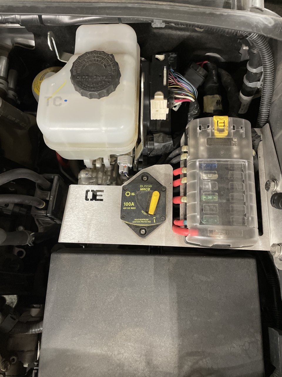

    Katzkin leather, heated seats, Popnloc, bed lights, remote start, bhlm....
    There’s a previous thread on this. Before I installed the panel I cut off that section and reinforced the wiring with wire loom and tape. The mount is still solid without that section. Mine has been this way for a year so far

    Please take some personal responsibility. You installed a shitty part and didn’t realize / understand how and what moves in the engine bay and what problems it could cause. You implicitly trusted a bad vendor, that’s on you and them. There are multiple single points of failure on the brake system of every single vehicle ever built. It was never a Toyota part or design that was at fault in this case, only you (or installer) and the vendor.

    I just had a chuck of metal hit my passenger side under truck on freeway about mile later traffic came to stop to my surprise no brakes that emergency brake saved my azz and had to use it another 15 miles or so to get to my shop. Lucky for me their is a hot rod shop nextdoor they gave me hard tubing and a snap on flaring tool and tubing bender set so I made new ones for both sides .

    wow im glad I found this thread. Literally have the same bracket, was about to install it. TW knowledge on how to fix shitty parts strikes again

    To all those who've actually talked through the issue and had meaning contributions, thank you!
    Unfortunately I'm still having the issue. I patched (just until I know the fix) the wire. Modified the mount. Let it all sit off battery over night (twice, long story) and still no change. Getting more nervous it's a major (EXPENSIVE) issue.
    Here's a video from the night it happened. I was able to limp it off the trail and park at a friends house just down the road. Still getting all the same warnings now.

    Did you "patch" it right?

    Did you check all the appropriate fuses? If the wire was actually comprised (therefore needing a patch) then it most likely / hopefully popped a fuse
