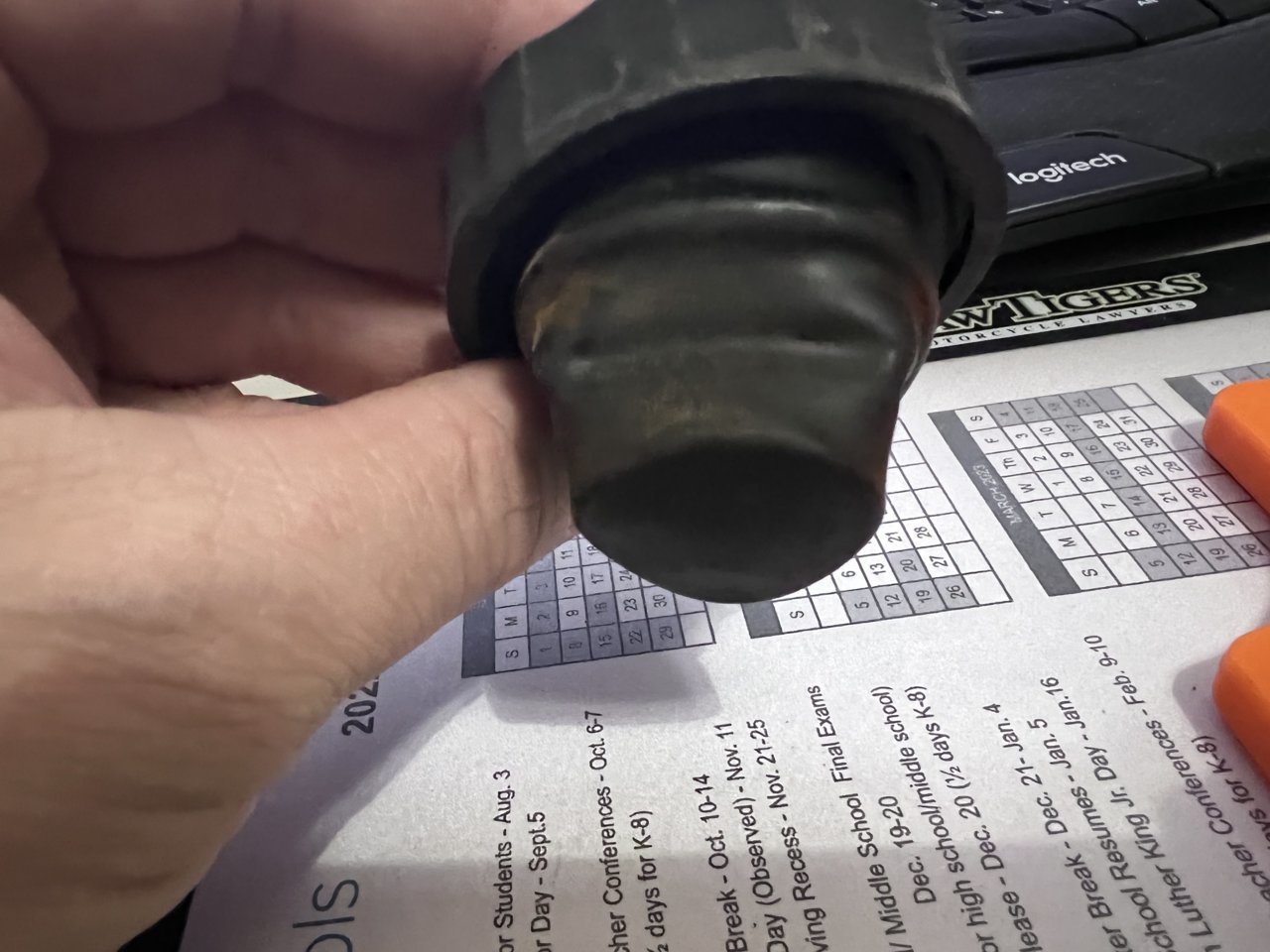

    This is true on the motorcycle side. The there is a valve in the automotive caps, but there is air exchange due to fluctuations in ambient pressures. It is not completely sealed. Otherwise, brake fluid would never be able to absorb moisture if it was truly a sealed system.

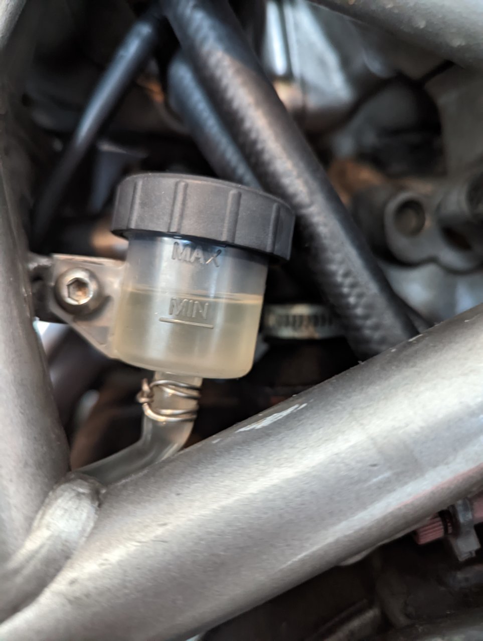

    As a certified Harley Davidson, BMW, and Suzuki tech, I was hoping that you would say this...
    And you are still false.
    I can go out to any one of the 7 motorcycles in the garage and take a picture and show you if you like...

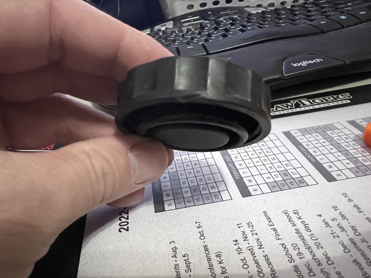

    I was hoping that you would say that you're a "certified tech."
    The bellows is currently retracted from a fresh flush.

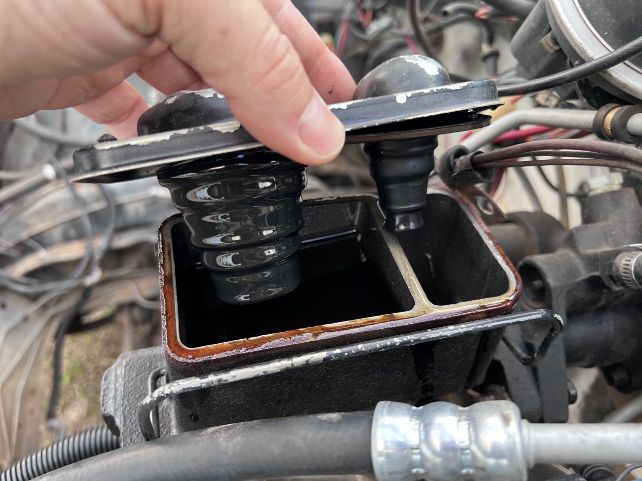

    Here is how the diaphragm gasket is when fluid level is at or near full…
    And if everything is working properly, here is how the diaphragm gasket is when the fluid level has dropped…
    Probably why you cannot see through your brake reservoir in your picture.

    No shit. I do my own work.
    That's nothing like the cap on the automotive side, as I said.
