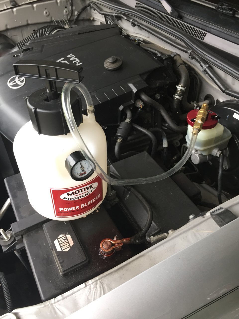

    What types of bleeder systems have people used? I'm thinking of buying the Motive Products bleeder but wondering if that's overkill. How much more work is it to just connect a rubber tube to the bleeder valve and have a helper press the brakes vs using the "power flush" type bleeder?

    I have a motive. Best tool I've bought and actually worked as advertised.

    I have used a motive pressure bleeder before too, works good.

    I bought a Motive and will be doing this on the weekend. My main question now is what order do I do the wheels? It's not in the hayes manual I have and I haven't found an answer yet, but is it the same basic setup for any vehicle? Farthest to closest?
    Also, is there anything other than the 4 wheels I need to bleed? On my 01 I had to bleed the load position sensor or whatever that is called, do the 2nd gens need that as well?

    I question this only as I recently was told that with ABS systems you bleed just the opposite from the old school: starting with the closest front and working to the furthest rear?
    I will gladly be wrong. :frusty: Just seeking clarity.

    I’ve only bled mine once in 9 years. I used the Motive Products bleeder
