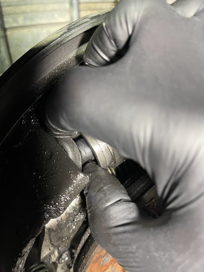

    #203721
    121
    Central Florida
    2013 Tacoma TRD Sport 4x4
    I don't see any liquid inside the boots.

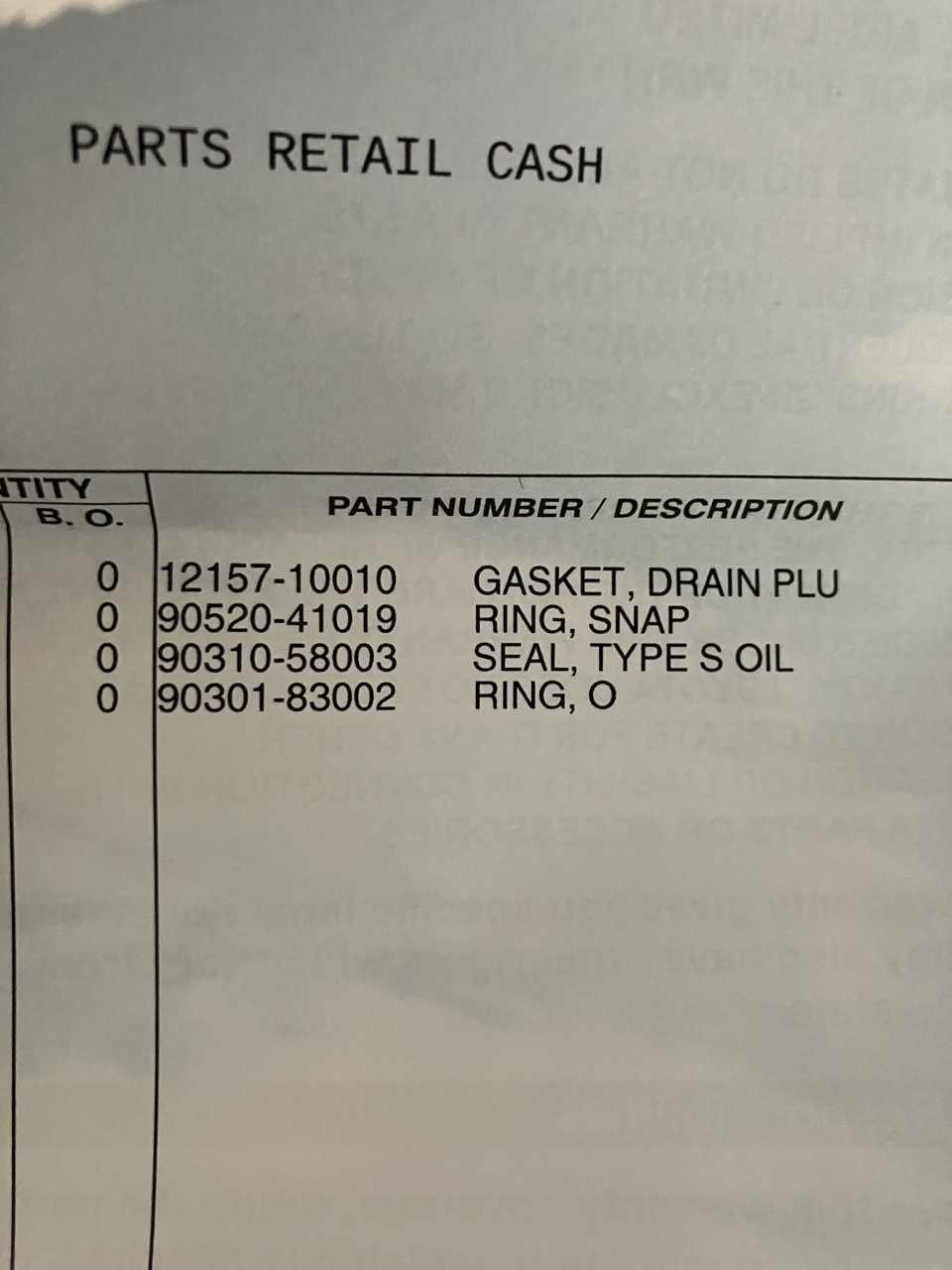

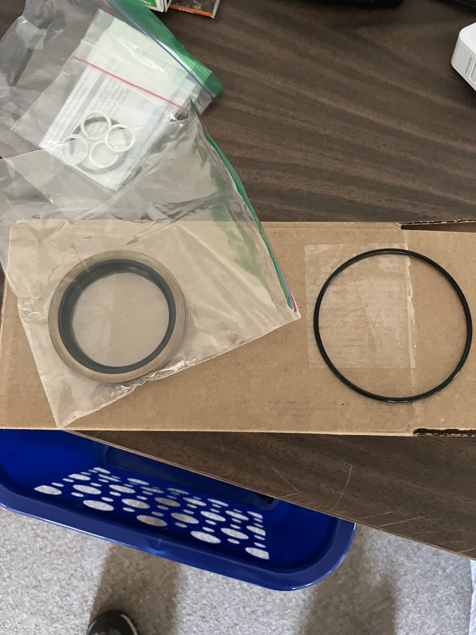

  13. Jun 27, 2023 at 12:48 PM
    #33
    TnShooter
    TnShooter The TacomaWorld Stray
    Sep 2, 2010
    #42625
    21,392
    Deogee
    07' TRD Off-Road, Auto
    STOCK
    Nope.
    Here, this is what I used
    You do NOT need the one labeled snap ring.
    Jimmyh and HondaGM like this.
