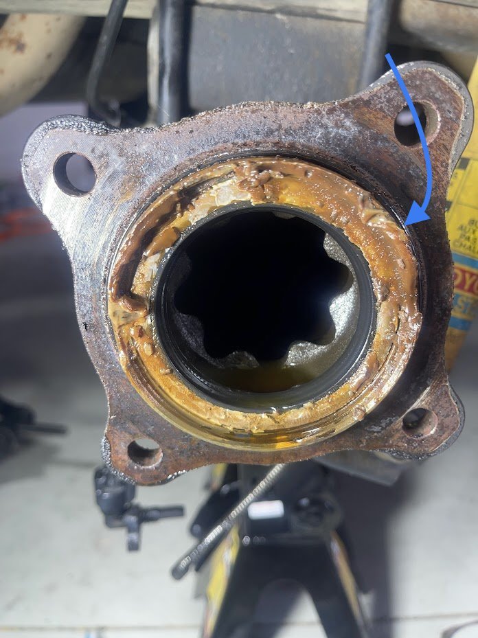

    Can you tell if that seal is bad by looking at it?

    Not really, not on most.
    However, mine did have prominent “bulge” at about the 4 o’clock position.
    But that’s not typically, I could have been me that “bulged” it when removing the axle.
    But I am still thinking it was the pressure that caused mine to push the seal out.
    You definitely have a build up there. And it’s almost waxy.
    Which isn’t what I see with brake fluid. But you’re there now.
    Little more advice, clean up the area where the o-ring rides.
    That’s your only defensive of water intrusion. I put some o-ring lube on mine just to help.
    But mostly to make me feel better. If you don’t have any, no big deal. But definitely make sure the matting surface is clean where the o-ring sits.

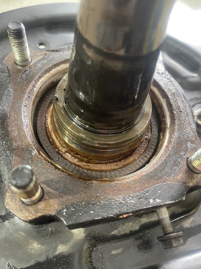

  12. Jun 28, 2023 at 2:05 PM
    #52
    TnShooter
    TnShooter The TacomaWorld Stray
    Sep 2, 2010
    #42625
    21,392
    Deogee
    07' TRD Off-Road, Auto
    STOCK
    The arrow is touching the o-ring.

    Just go back from Toyota. That O-ring is hard to find. I'm putting all back together now. Next, opposite side shoes.

    Is there a groove for the o-ring or does it set outside the rim?

    I don’t remember there being one.
    I believe the bearing assembly is beveled to accommodate for a “groove”.
    I just put mine back in the same spot and sent it. Been fine since.

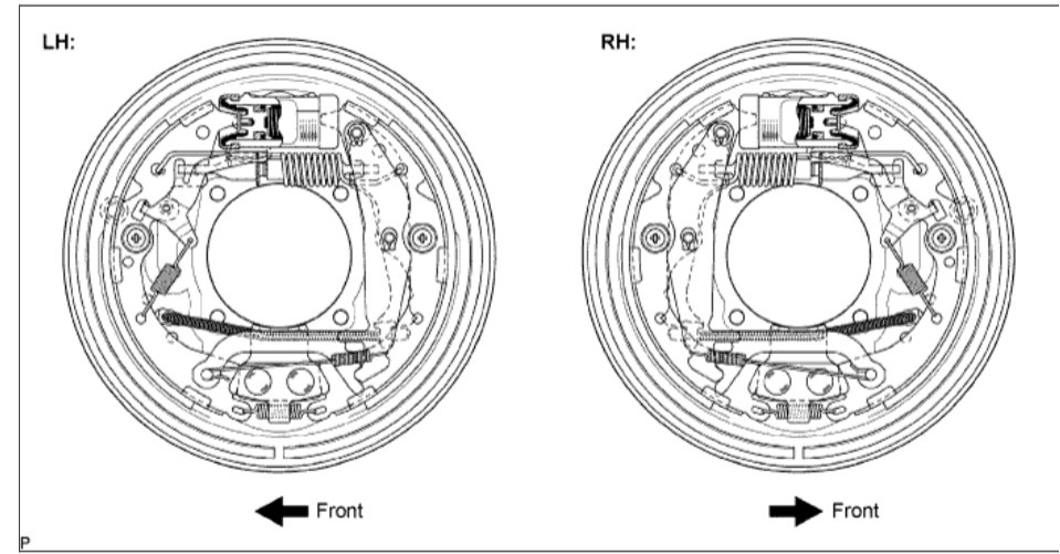

    So, is there a difference in how you install the left and right rear brake shoes? I see plenty of videos showing the left and indicating a certain way for the drivers side but nothing I've found mentions the passenger side.

    It’s the same for the both side.
