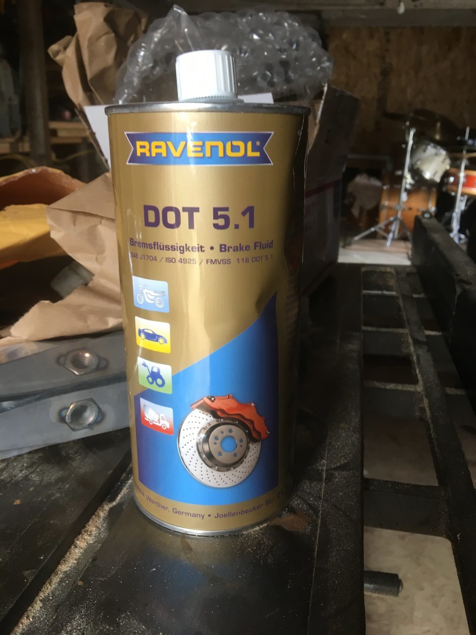

    I ordered some revenol 5.1 from Amazon (they also make the Toyota specified equivalent of our t case oil for a lot less $, which I have in the garage and will swap out soon). It has a much higher boiling point than dot 3 & 4. Curious to see if it has any noticeable improvements when the truck is loaded up. Quite likely overkill but not much more expensive.

    Just reporting back on this in case anyone’s interested. I flushed with Ravenol DOT 5.1 and brakes are definitely more responsive. That said, this is my first flush since I’ve had the truck, so maybe results are the same as they’d have been with DOT 3. The real test will be fade under load.
    So fwiw, there you go.
