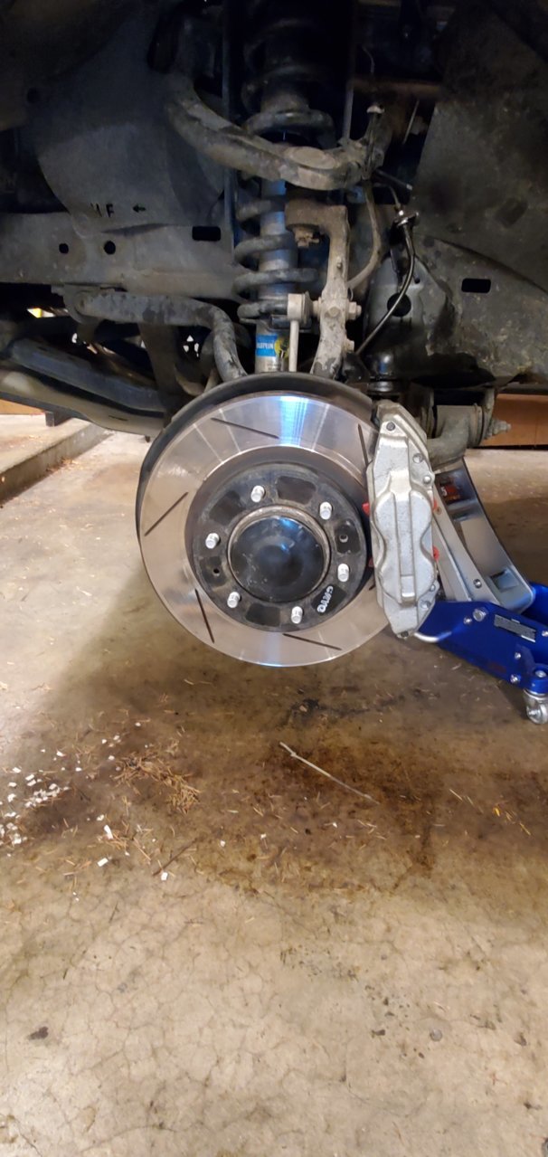

    crashnburn80
    crashnburn80 Vehicle Design Engineer
    Jun 6, 2015
    #156893
    14,771
    Kirkland, WA
    2003 DCSB TRD OR

  11. Dec 11, 2019 at 8:19 AM
    crashnburn80
    Jun 6, 2015
    #156893
    14,771
    Kirkland, WA
    2003 DCSB TRD OR
    Different rotor designed with increased cooling and more mass for greater thermal capacity, it is stock size. The rotor helps the brakes run cooler and helps prevent overheating. Then using Toyota’s more aggressive TRD pads, which helps with more bite from the brakes.
    PzTank and coopcooper[QUOTED] like this.
