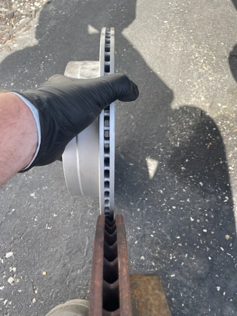

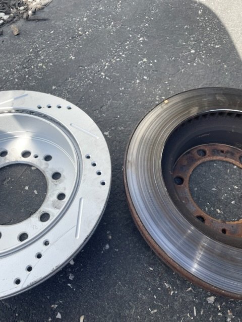

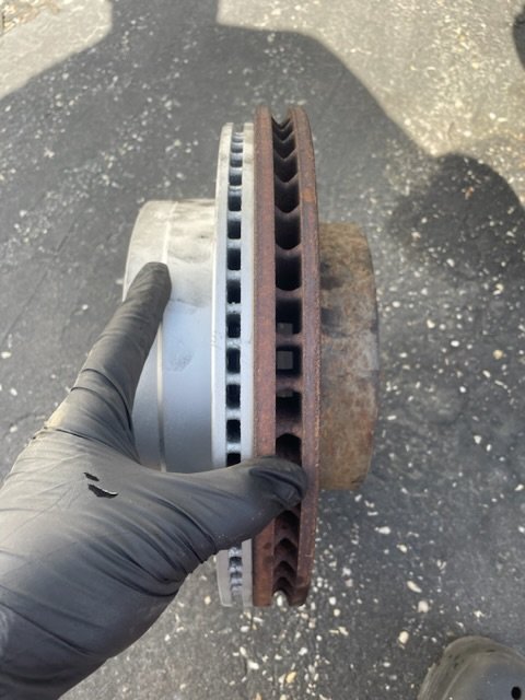

    Brakes came, so excited!!! But then:
    F713BF17-C6AF-4F45-B6D9-DD862FCA9727.jpg 5D2CE7B7-0023-4322-A17A-EC56216EF01B.jpg

    The brakes i ordered specified for my year make model 4wd 2.7 stick…
    Rotors received were smaller, thinner, and the lug pattern was correct but they didn't sit flush to the hub.
    Were there different size brakes as options or??
    in doing further research and a measurement my rotors are 12.56”/319mm and I got something smaller but finding confusing info.
    Are the parts on my truck a homebrew oem brake swap and thats why the new parts dont fit?

    Those are 4runner rear rotors.

    Is there a way to be certain of this?
    I've been advised to return the parts for a credit and I ordered a set of Powerstop rotors/pads that I confirmed match the measurements of the rotors currently on the truck so it seems that somewhere there are multiple options available. Even Advance Auto/Autozone have 2 sizes listed on their site, guess i should have done more research before buying but at least i’ll be able to return the items and get a refund.
    for reference, I used PartsGeek and none of the items have a size or dimension listed in the description so I wasnt aware of the issue. Lesson learned on that…
    Powerstops should be delivered by tomorrow so i’ll get it together on Saturday.

    Well, you can tell they're rears because they have a parking brake drum machined into the hat. 1st and 2nd gen tacomas have 2 options, 5 and 6 lug, and they're different size.

    referring to the new units, not the old, correct?
    i thought something was off with them and that lip on the inside.
  16. Mar 30, 2023 at 9:34 PM
    #36
    lbhsbz
    lbhsbz Well-Known Member
    Dec 15, 2009
    #27618
    634
    yes. The old ones are obviously fronts since the Tacoma doesn't have rear discs.
