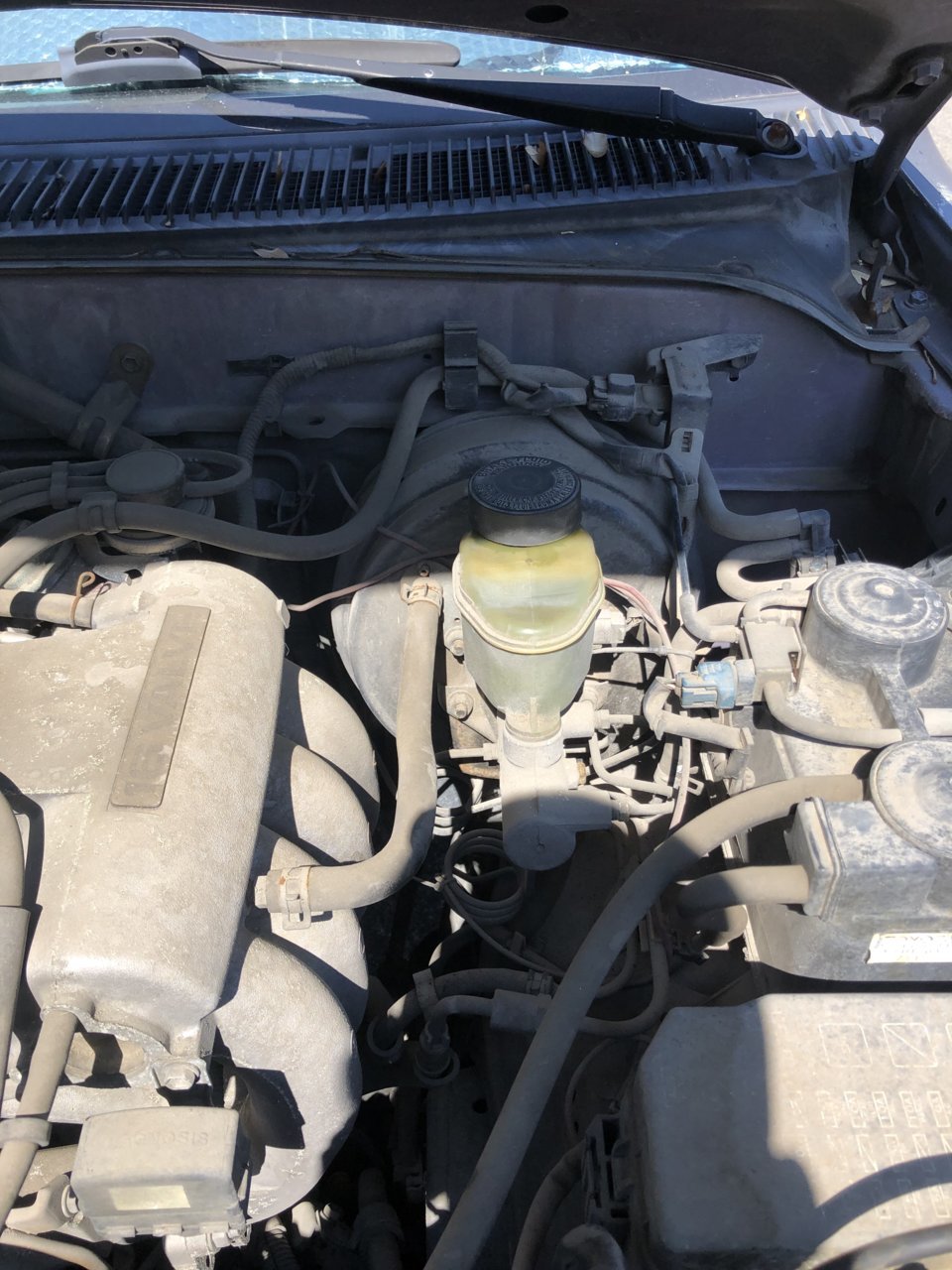

    I thought the issue was air in the lines so I bleed out the lines. Brakes felt ok till I turned on the truck and I could hear an air sound and had complete brake loss.

    Oh this is happening to my 1998 tacoma 2.7 liter no abs 4x4

    From what you describe, is sounds like the power brake booster went away.

    If the pedal feels hard and no brakes then it's your brake booster. Mine made an air whooshing sound when it failed also. Toyota OEM boosters are discontinued so you'll need to go aftermarket.

    I was afraid it was going to be the more expensive and cumbersome part to replace. Thanks guys I appreciate it.

    I think the OEM booster had a list price of $1200, and an online price of $800. Makes me kind of happy it's discontinued so I didn't have to make that decision.
    Consider doing the brake master cylinder at the same time. You have to take it off anyway, and if it's 20 years old at this point, it could go soon. Or buy the rebuild kit for it at least and change the seals.
