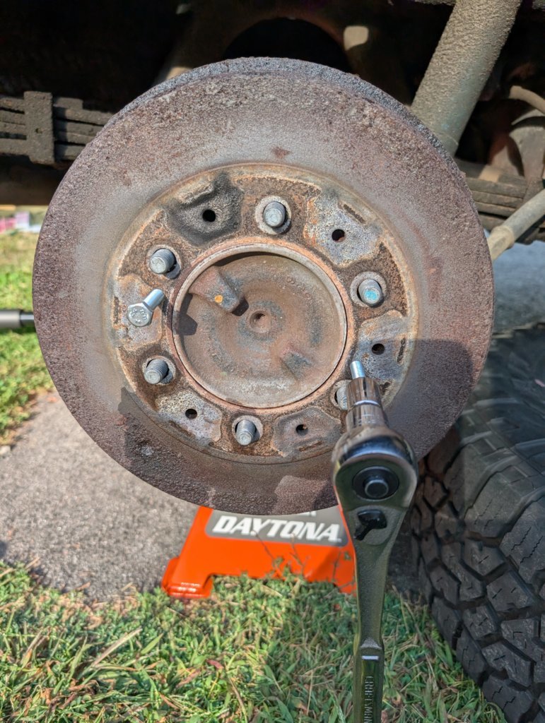

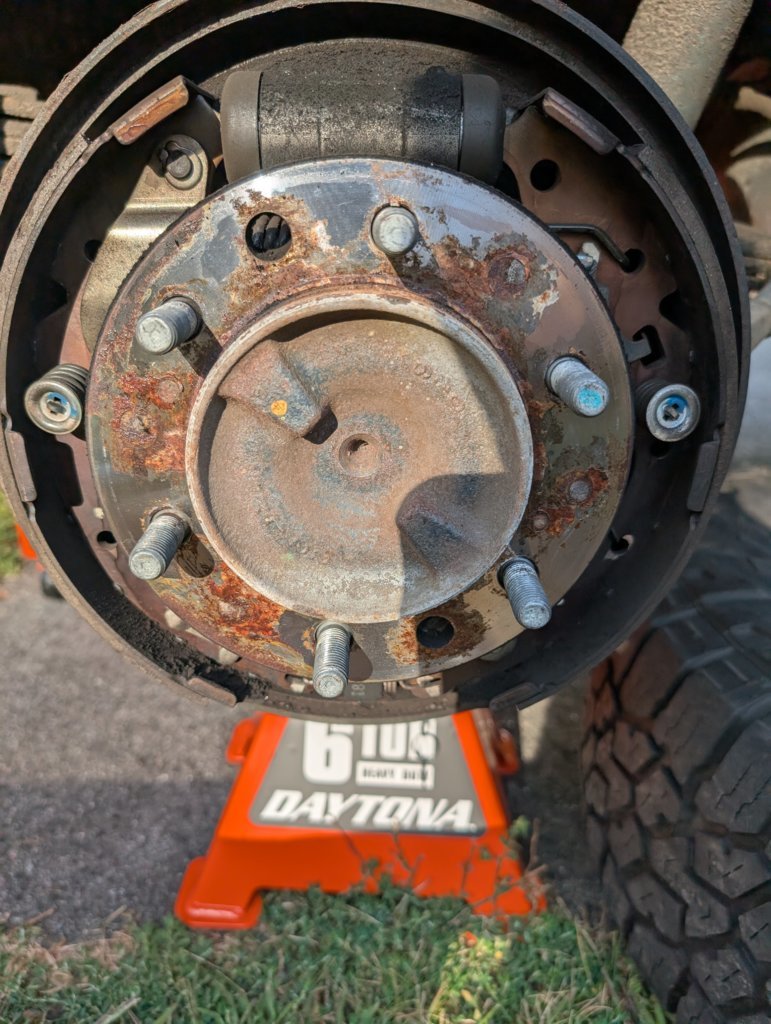

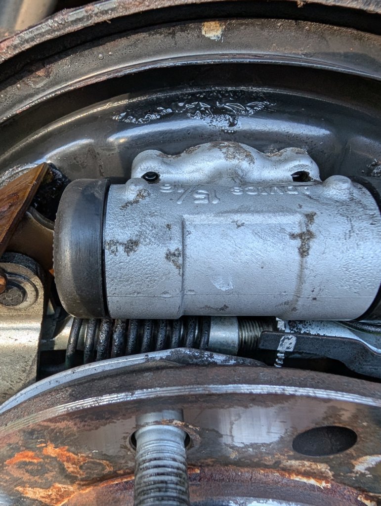

    Just a final update, I had a chance to jack the truck up and take the rear wheels off. The right wheel was pretty caked in brake dust so I cleaned it out, re-greased the pivots, wire brushed off all the loose rust/surfaces and then re-adjusted the star wheel. Seems to have fixed everything. The only thing that looked off to me was that one of the shoes had lost some material on the corner of one of the pads. I'm speculating but maybe some rust fell into the hub and got jammed up at one point. While the inside of my drums and shoes both looked good (no grooves, good pad life at 82k miles), the external parts of the drum are heavily rusted so maybe some rust was getting trapped/caught either inside the drum or around the lip between the two surfaces. I did notice that when my star adjuster was too tight, my brakes didn't just drag too much, they clunked to a stop (maybe I've got an uneven surface somewhere on one of the shoes). Backed off the shoes and its spinning good with some resistance and the stuck brake/dragging issue has gone away for now. Probably due for new shoes and drums by 100k due to rust more than anything.
