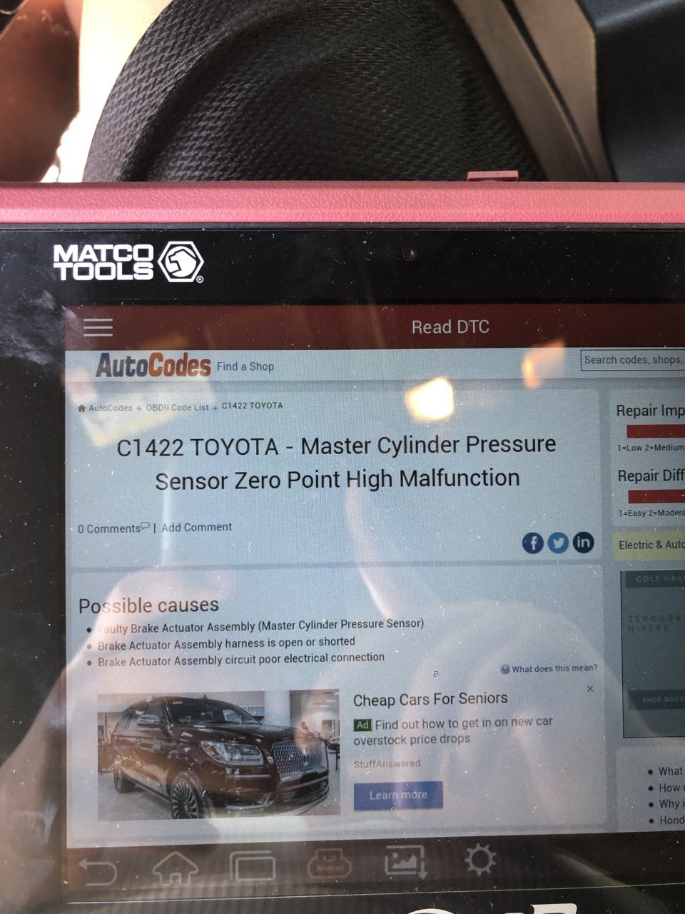

    It’s giving me this as the possible causes for that code.

    being that it is a salvage.. seems like the first place to start would be the wiring. which is what the trouble shooting file i linked to early states

    There’s probably spec somewhere like on TIS, and maybe your owner’s manual, but you want to make sure there is just a bit of free travel in the pedal before it starts to move the piston in the master cylinder.
    If the pushrod is too long, it essentially holds the brake fluid from returning to the reservoir, and heating up the brakes / calipers with repeat braking causes the fluid to expand and build pressure in the hydraulic system. That’s why cracking the line loose “resets” things until the next temperature cycle.
    A plugged vent port in the MC can do this too, but I’ve only ever seen that with cast iron cylinders that were rusted to hell. Anything is possible though.
    I think your pressure sensor code is because there is pressure in the circuit when there shouldn’t be, and is just a symptom of a mechanical / hydraulic issue.
