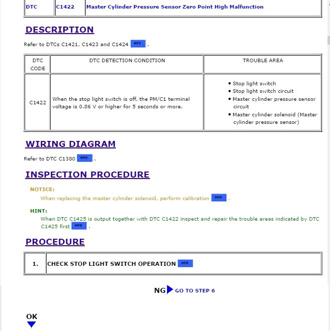

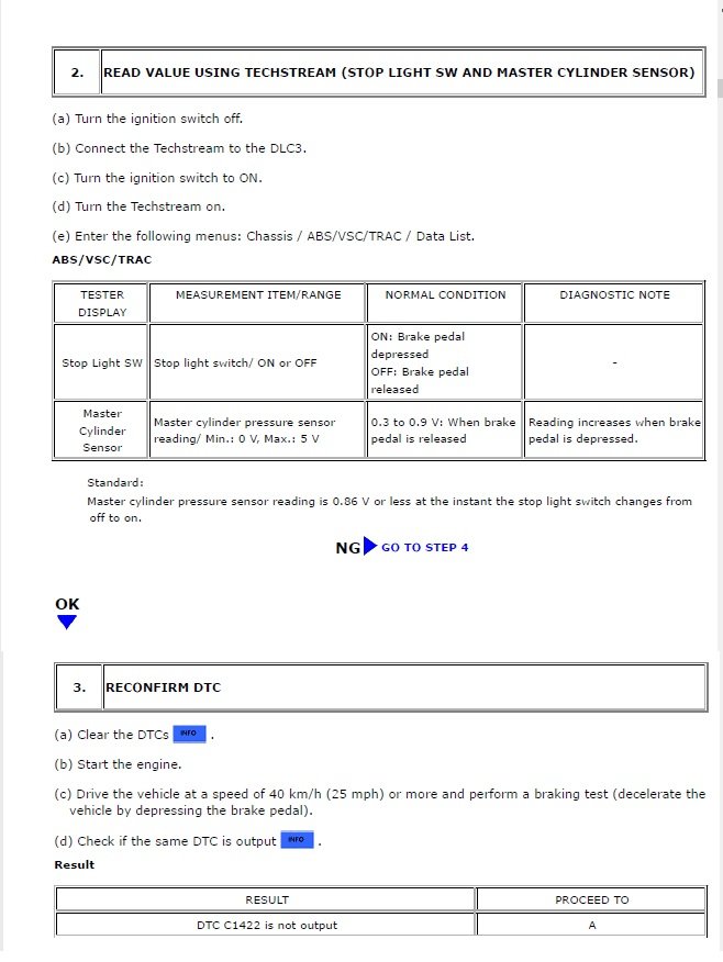

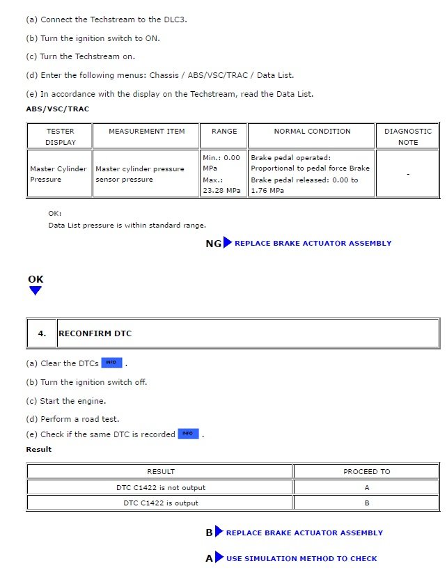

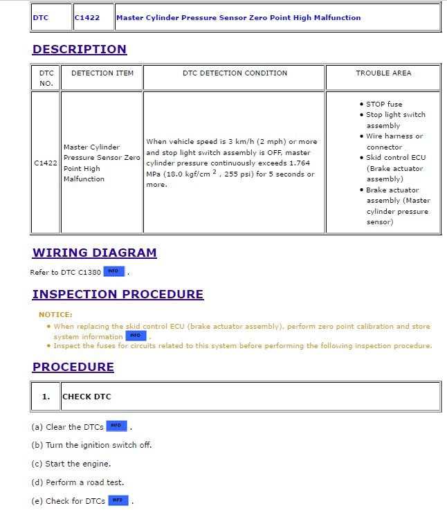

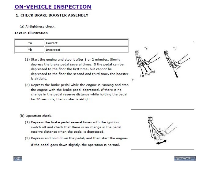

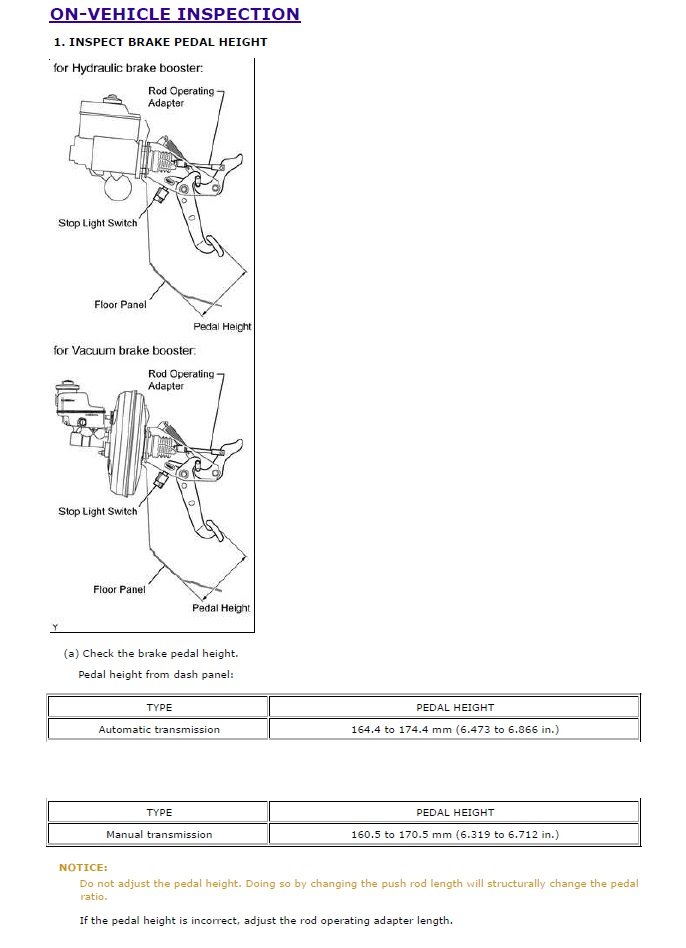

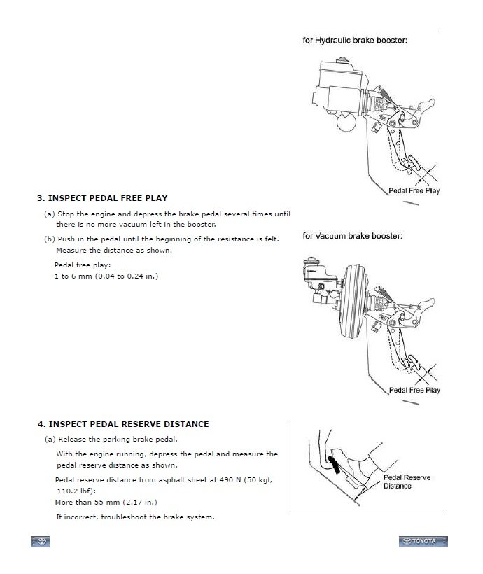

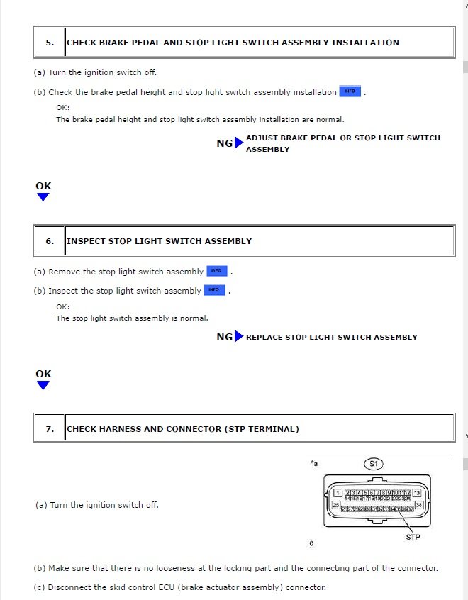

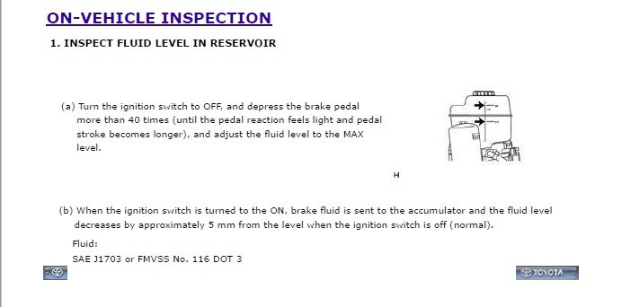

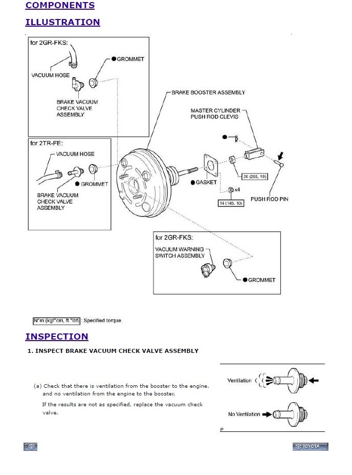

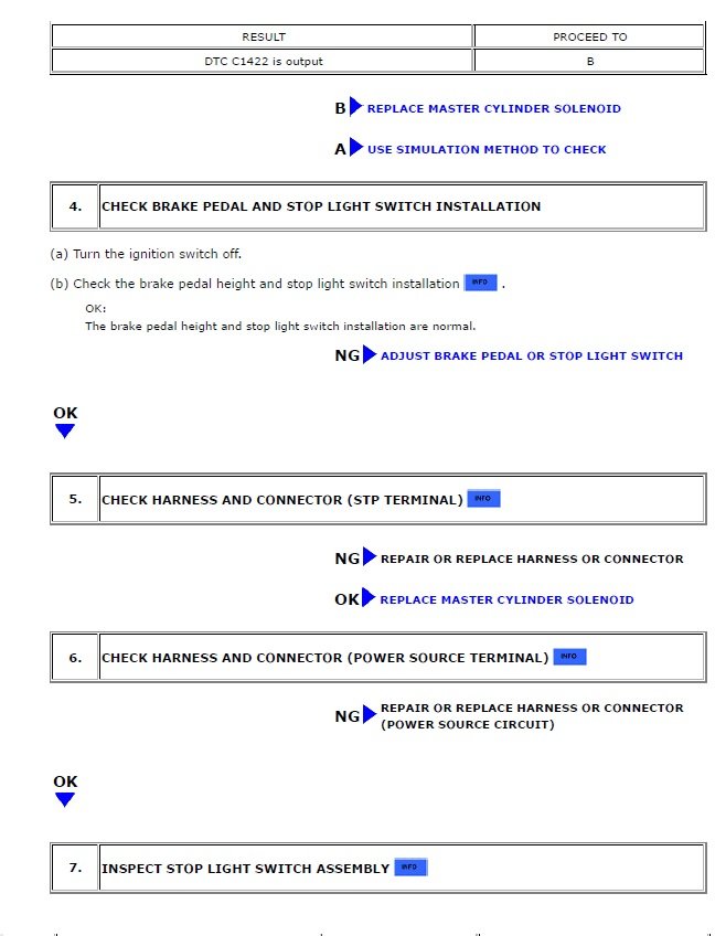

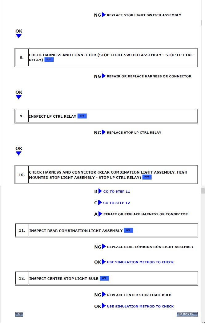

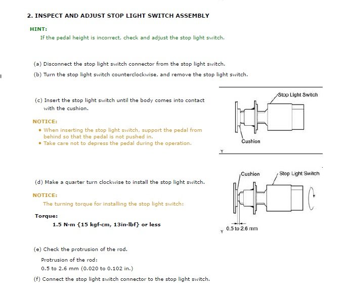

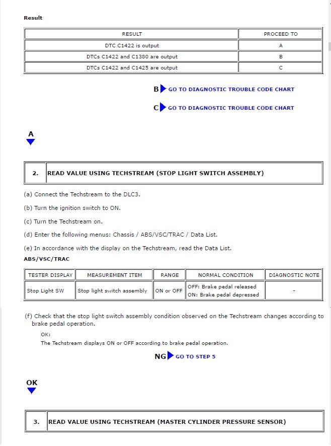

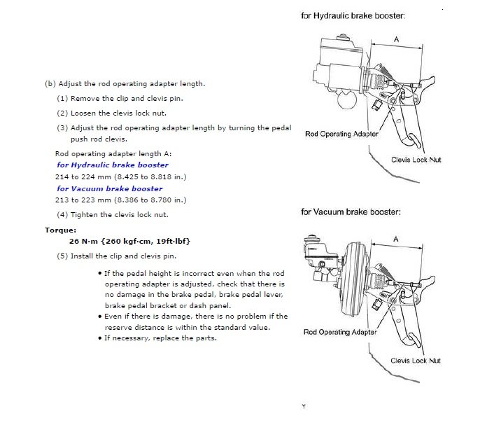

    Here are the mechanical and electrical flow charts for that code; along with some other inspections.
    You'll need Techstream to do a bit of it.
    You have a hydraulic booster, btw.
