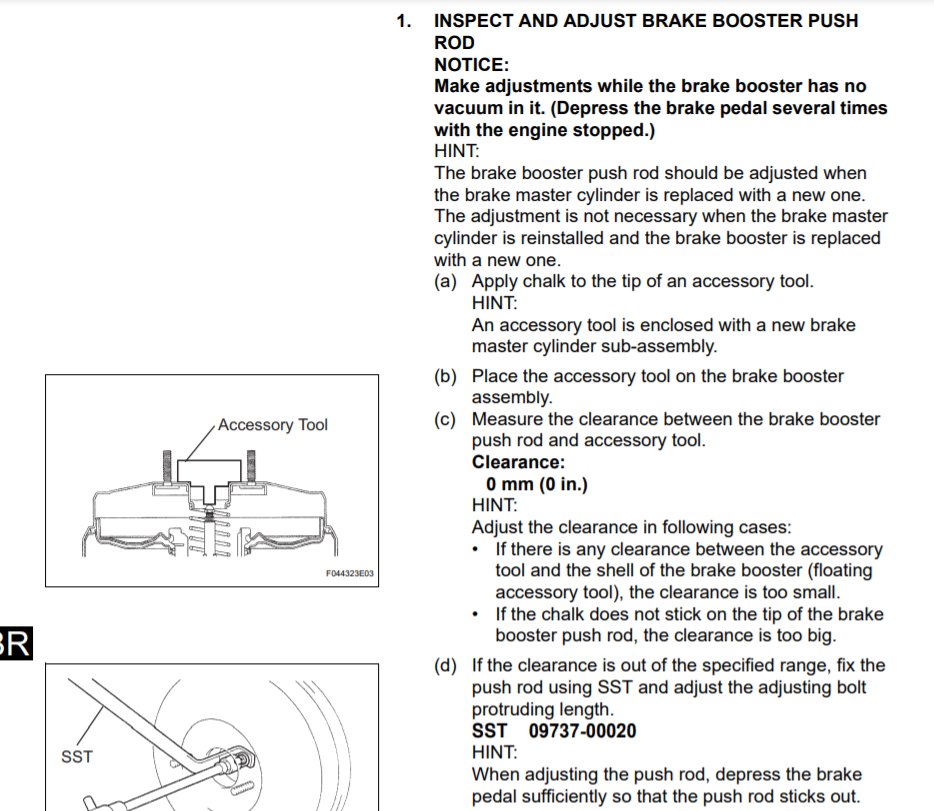

    If both sides are locking up then it's not a caliper or brake line issue.
    Like Bishop mentioned, look closely at the booster pushrod adjustment

    This gets my vote as the answer.
    I’ve had this happen to me twice. At the end of the mc pushrod, I didn’t leave any play, so pedal up it felt like the brakes were released but it was just barely pushed. Eventually pressure built up and locked up the brakes.

    I agree, they come as a set from the factory, so if you replace one you need to double check that free play adjustment when they are replaced.

    I got into trouble on a old Lexus LS400 a few weeks ago trying to replace a leaking booster. The only one available was a reman from OReilly, I had to remove it several times to get the adjustment right. Super annoying and wasted a ton of time

    One of these will work just as well as the fancy toyota "SST" and you can also just use a pair of vice grip pliers to hold the pushrod out while you make the adjustment.
    https://www.amazon.com/Power-Brake-Booster-Adjustment-Tool/dp/B079QGXY55
