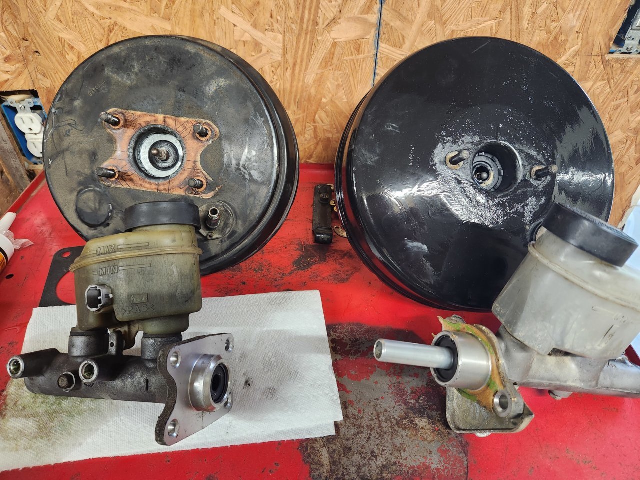

    Had some personal issues in my life that have delayed this project, and I have been borrowing my dad's truck in the mean time.
    Anyway, just pulled the booster today and realized the replacement I got from a 2004 was larger and used a different bolt pattern.
    Called a local dealership and they told me the price for a new one was $1000.
    I laughed at the parts guy and hung up.
    Now I'm back on the hunt for a replacement, otherwise I'll just have to pick up an aftermarket part.
