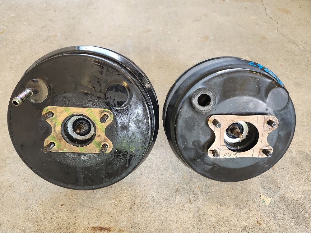

    I forgot to update this thread.
    Picked up an OEM brake booster on eBay, but found that when I pulled my old booster that the new one was a bit smaller.
    Installed the new one anyway and backed out the driveway, brakes worked perfectly.
    Thanks again for all the help, fellas.

    Any idea regarding the different size booster?
    Will it affect braking power at all?
  9. Aug 24, 2023 at 1:34 PM
    #29
    02hilux
    02hilux What do you mean there’s no road, I’m here
    Sep 14, 2016
    #197244
    6,166
    Planet: EARTH
    It will. They're both dual diaphragm but the larger one will generate more pressure vs the smaller unit.
    The smaller unit look like it's from a T100 or 4R

    Was sold as being pulled from a Tacoma.
    The last one I got was from a 4Runner, bolt pattern didn't line up so I found this one.
  11. Aug 24, 2023 at 1:37 PM
    #31
    02hilux

  12. Aug 24, 2023 at 1:42 PM
    #32
    02hilux
    Sep 14, 2016
    #197244
    6,166
    Planet: EARTH
    I switched the 4R booster out after I was able to source the larger booster from a early tacoma with an 1" MC even tho the 4R had an 1 inch MC too.
    When stopping, I can tell the larger tacoma booster stops better vs the 4R vs the factory single diaphragm 01-04 booster.
    I do know that the larger booster is nolonger being made/reman and the smaller unit was use in its place. That's why I replaced my single with a 4R until I was able to sourced the larger booster a year later.
  13. Aug 24, 2023 at 1:45 PM
    #33
    02hilux
    Sep 14, 2016
    #197244
    6,166
    Planet: EARTH
    What you meant to say is, the MC from the pre-00 is 1" with 4 bolt mounting and is dual diaphragm. 01-04 are 15/16" with 2 bolt mounting MC and single diaphragm. That's the difference.
    Would still work if you kept the MC from the 01-04 with the 01-04 booster.
