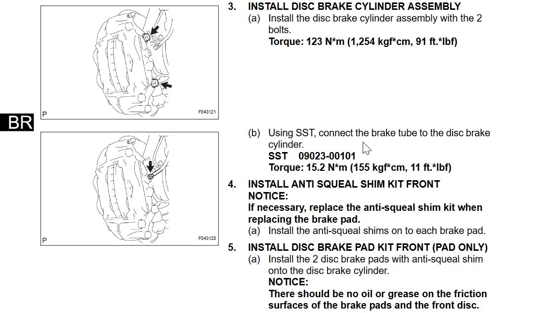

    Look at the bolts when they're removed. They have thread locker on them.

    So the short answer is that you cannot show in the Toyota Service manual that says to use Loctite on the caliper mounting bolts, because it doesn't say it nor is it implied. If you apply a liquid to the threads then the torque value will have to be adjusted accordingly. Do you have a formula for that? I would guess no. I even attached a copy of the page for brake installation.
    I know about the various types of Loctite, see where I recommended they use Blue 243 if they use it at all:
    How are Toyota Brakes their own unique design?
    I have to disagree here. They ( 6 lug trucks ) are the same basic fixed caliper disc brakes as used by many auto manufacturers. And the 5 lugs use a basic floating caliper design as used on many cars and trucks...
    How are they unique?

    From this PDF Document you referenced for informational purposes it says this for the temperature ranges of Loctite:
    So 300 Degrees F maximum.
    Now there is this: https://www.motorauthority.com/news/1109461_thermal-camera-shows-how-hot-brake-rotors-get-during-use
    During normal street use, brake rotors and pads normally won’t see temperatures climb past 200 degrees Celsius, or 392 degrees Fahrenheit. However, track days are a different story, with temperatures potentially reaching 1,000 degrees Fahrenheit as the brakes are called upon more often and more aggressively.
    And if you add a little aggressive braking the Loctite isn't going to hold up very long. Yes I know that they are discussing the pads and rotor temperature. If the rotor is getting up to 392 degrees F it is also heating the mounting bolts of the caliper as it is in close proximity.
    I'm not trying to persuade you to change your ways, you can do as you please just as everyone else can. But to say that Toyota says to use Loctite on the caliper mounting bolts has no reference that I can find in the Shop Service Manuals
    I'm now off my soap box. Sorry If I offended any sensitive types with my post. I just hate to see misinformation posted as fact.
