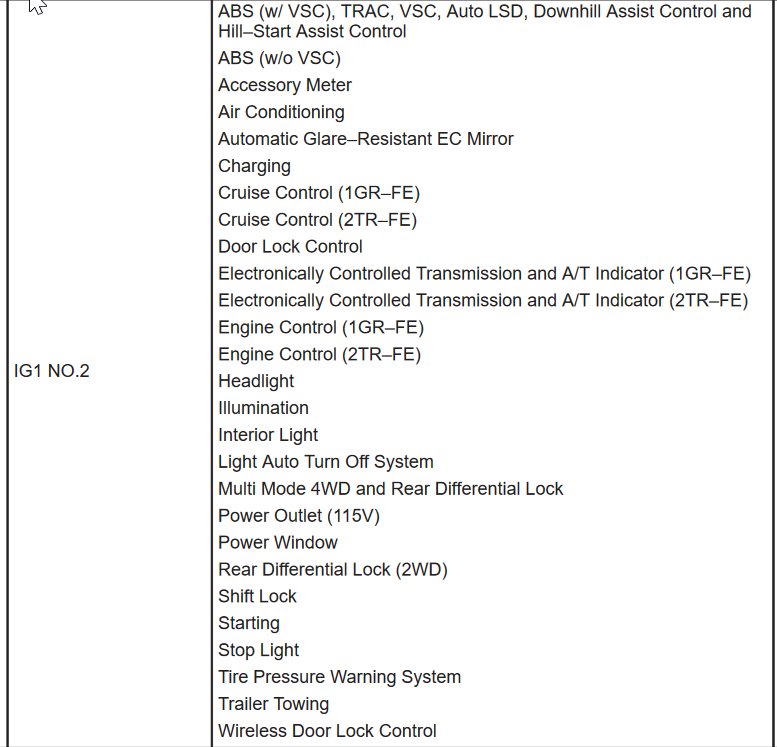

  12. Feb 23, 2021 at 3:10 PM
    Jimmyh
    Jimmyh Well-Known Member
    May 16, 2012
    #78991
    14,286
    SC
    2012 Prerunner SR5
    Here is a list of all the loads on the IG1 No2 Fuse:
    TnShooter likes this.
