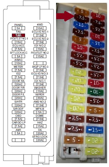

    Brake light drls and license plate lights not working. HELP!!!!!!!When I step on the brake the brake lights work but the drls don’t come on

    The back DRLs only come on when the headlights are on.... if they're on probably a fuse

    What position do you have the light stalk in?

    There's a TAIL 10A mini under the steering wheel in the fuse panel.
