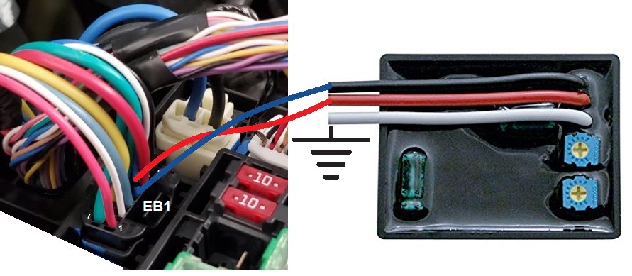

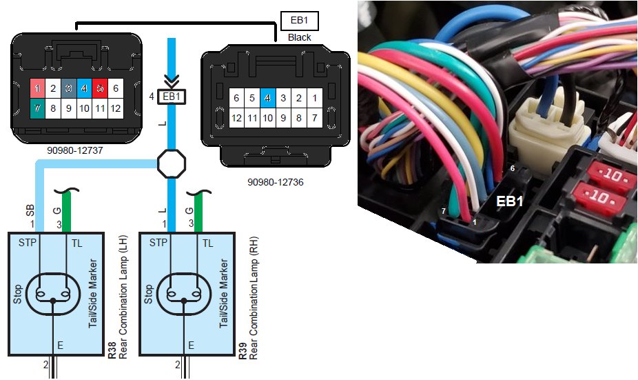

    You will have to cut the blue wire...
    If you have the skills, you could purchase the male & female terminals e.i.; 82998-24340 and 82998-24350.
    Neg Battery Terminal OFF. Wait a few minutes.
    Remove the connector, release the locking bar, insert a tiny flathead screwdriver or proper tool, to release the locking pin and remove the terminal.
    Solder n Heat shrink or Crimp the repair wires to the flashing module.
    Place a length of heat shrink on the terminal that will mate with the removed one from the connector (female) mate the terminals and place heatshrink and shrink it. Insert the other repair wire into the removed connector correctly. If it does not insert smoothly remove and rotate it 180º. It will make a "click" noise. Replace the locking bar and insert the connector back into it's location on the fuse box.
    Replace the battery's neg terminal.
    Have someone observe as you press the brakes.....

    2018 White Tacoma TRD Off-road
    Just to confirm from your picture, it looks like you are referring to the dark blue wire that is a bit hidden in the connector or #4 on diagram? Removing the dark blue wire #4 and connecting it to the Modules Red wire and then connect the black wire with pin connector and reinsert it in the connector? Sound about right?

    Yup. My truck with the module, and it came as an embarrassingly priced dealer add on. On the double cab, it's spliced in under the passenger rear door sill. I probably paid a 3000% markup on the part.
    I don't mind having it though. I now notice every other vehicle with 3rd light pulse, so god knows it works as intended.

    Yes
