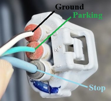

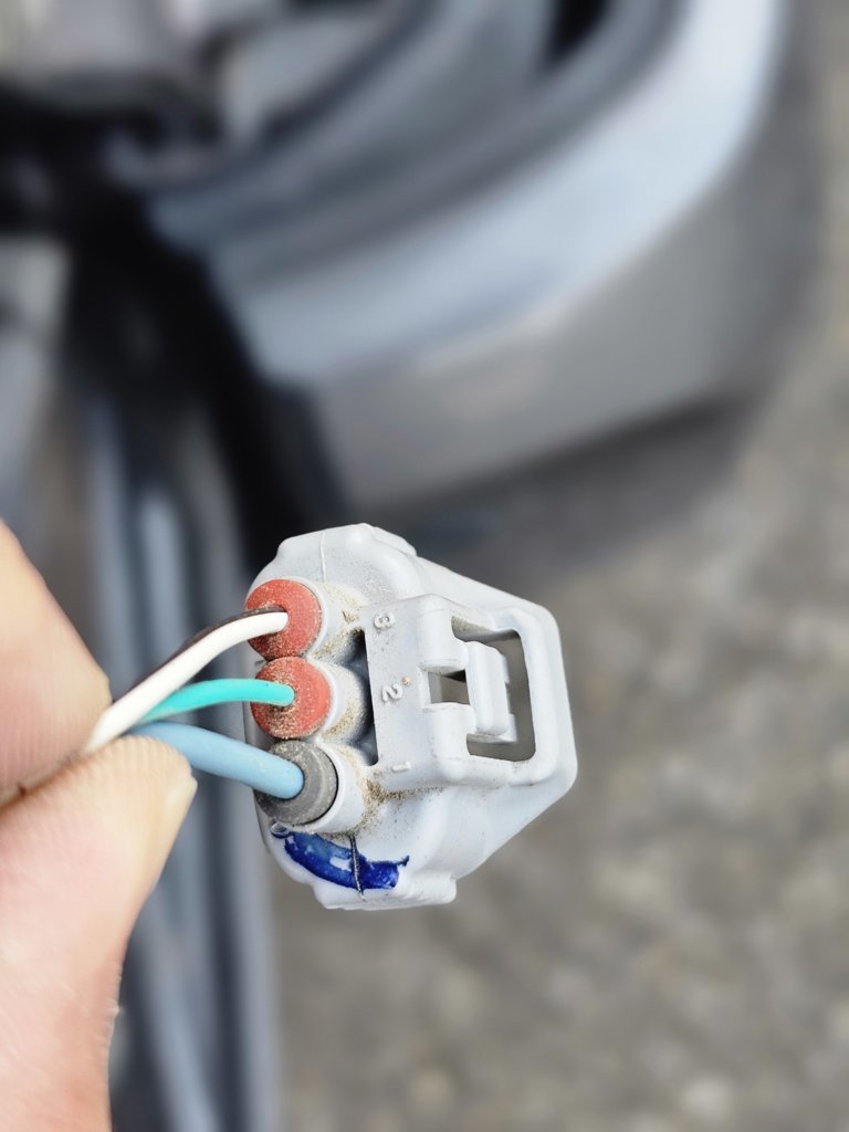

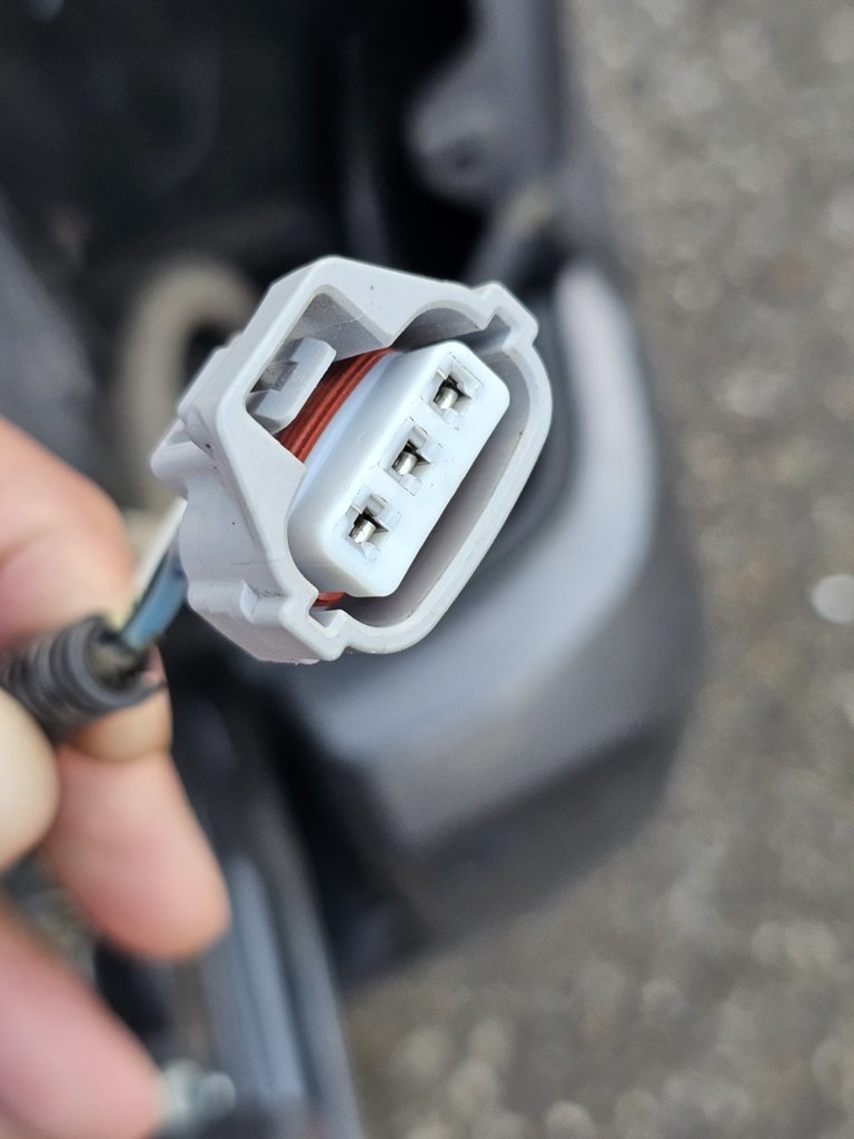

    My right rear brake light works intermittently. This is the top bulb. When it doesn't work I can smack or tap it and it comes back one. I've troubleshooted it to the electrical plug. The gray plug. I've done this by swapping the bulb and black-bulb plug with the opposite side. The problem stays with the GRAY plug. What do I do now?
    Can I take this apart and clean/fix it?
    Do I make another connection with a new gray plug?
    Can I spray something inside to help the connection?
    I'm not taking my truck to the dealership because I think they'd spend a year trying to fix this sort of thing. Even after I troubleshooted it to the plug.

    Hmm, the plug doesn't seem to have any corrosion or heat damage that would make the connection poor. Can you plug the bulb and holder back in (separate from the taillight assembly) and kinda move it around and wiggle the wires to see if you can replicate the problem and narrow it down further?

    What about a pic of the lamp holder (without the lamp)?

    It's the ground (white/black stripe) wire. I wiggled it and now it wont work at all. Any thoughts on fixing it. Is there a way to take the wire out and solder/reset the connection. Is there a way to take these apart and rebuild them?
    It is not the bulb or the bulb plug (black plug). I've test/troubleshooted those parts by swapping them with the other side. The both work consistently over and over again. I would love to have that be the problem. It would be a very easy to fix.
    EDIT: OK, maybe on an idiot. I'm going to find another, another, new bulb to test with.
