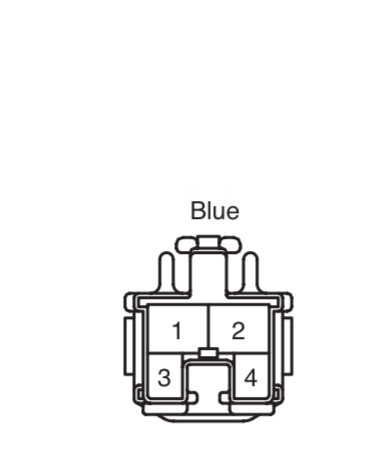

    Power flows from the Battery through the 10A Stop Fuse through the Green/White wire and into the Stop Light Switch. When the switch is press, power flows out through the Blue wire to the Stop Lights.
    Good luck, hope you figure it out:fingerscrossed:
    Cheat sheet =
    Green/White wire = Power In
    Blue wire = Power Out

    Your wiring is the same you could snap a picture of your brake switch pigtail, I was gona post a picture of mine but it's different.

    Maybe we can settle for a pinout for now?
    If OP needs an actual picture, I can try to get one tomorrow.
    The plug is Blue if it has
    1 = Blue
    2. = Green/White

    I posted the pinout of the switch, I couldn't find the connector pinout picture.
