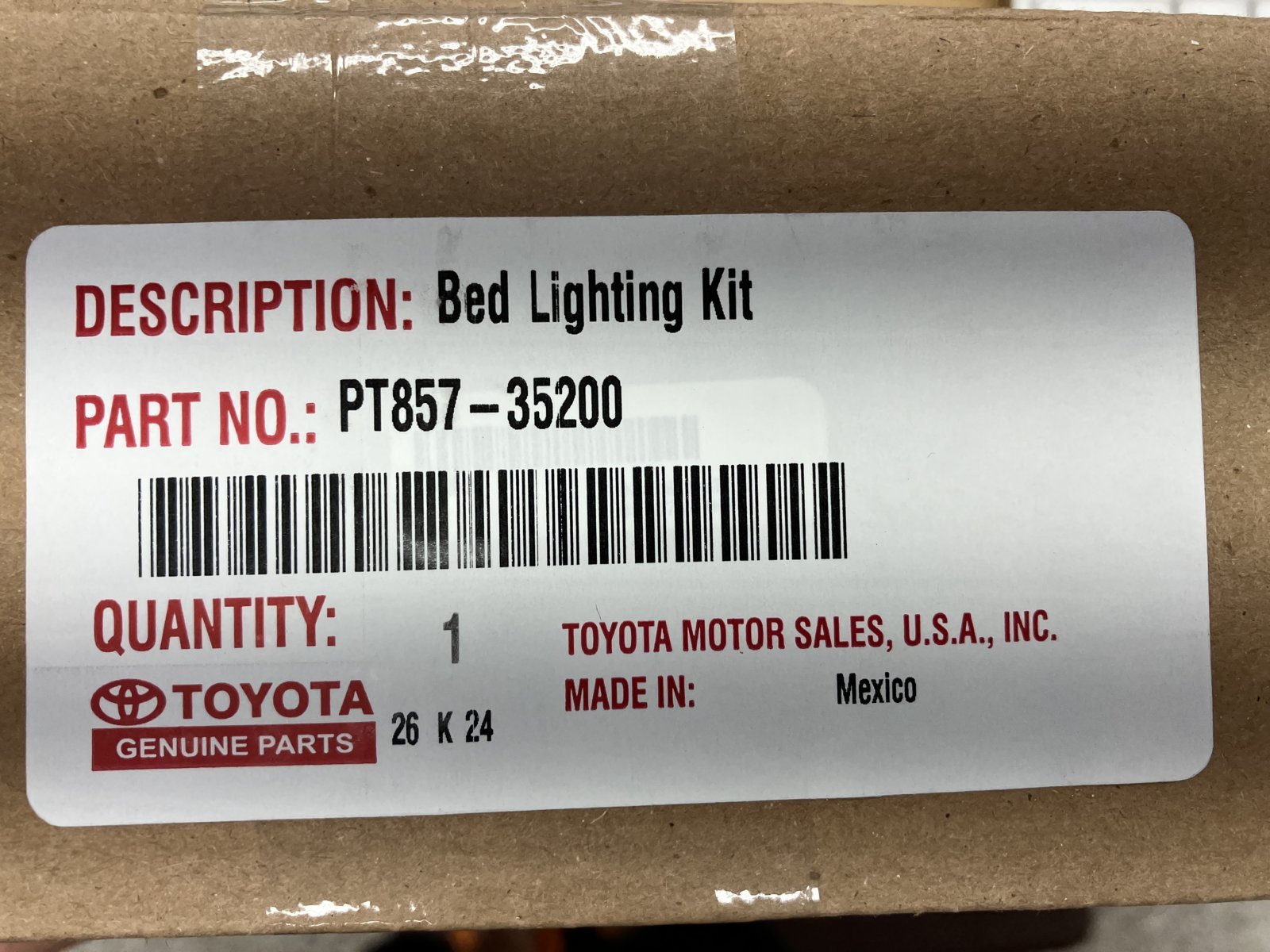

    Bed light connectors are inside your taillight cavity. Oem bed lights are a cheap and easy mod, very worthwhile if you don’t already have them.

    And thank you for the info on the bed lights. Will also be ordering. The 2018 I had did not have that nice simple option.

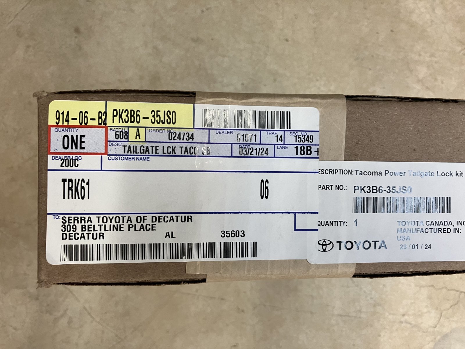

    Also Oem tailgate lock. I just bought these for a friend of mine who is doing work for me as a sweetener to get him back for more work :)
