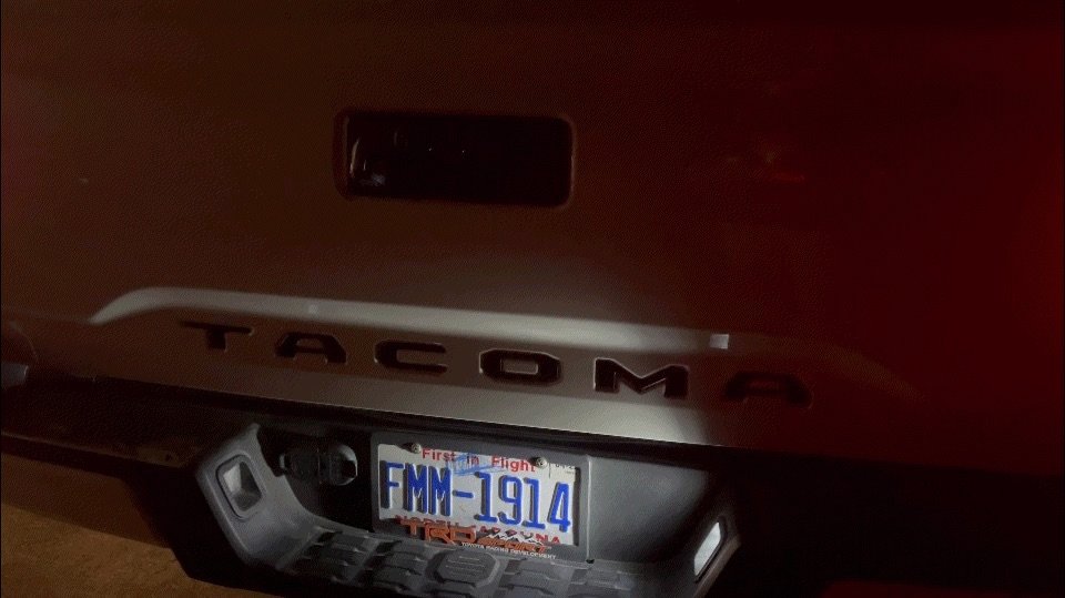

    Edit: The issue appears to have been related to the LED bulbs. I replaced the LED bulbs with incandescent and the issue appears to be resolved (cannot yet say with certainty). The Meso harnes works with incandescent bulbs and the switchback reverse/blinker LED has not given me any issue. Post 67 has video of it.
    Update: So, after cold soaking overnight the break lights on my truck are flashing. I first noticed it at -6 F, however it is significantly worse at -38 F.
    This is without me toyching the truck since the night before. No dash lights. No other issues. Still runs, and flashing stops as the truck warms up (but not until it warms up, turning it on does not change anything).

    This morning my brake lights are randomly flashing with the truck turned off in the driveway. It is more of a flicker as the lights don't come on enough to fully illuminate the housing. There is no predictable pattern, sometimes the flashes will be in rapid succession, and sometimes there will be a minute or two between flashes.

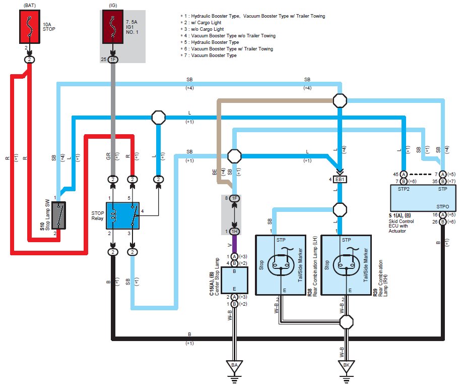

    Brake switch...
    lostMarbles[OP] and Skydvrr like this.

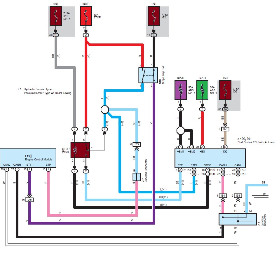

    2016 TRD Bro
    [S]Un-Molested[/S] Lightly Molested
    If it's ground switched circuit then any grounding after the lamp will complete the circuit and lights will come on. Shotty wiring, poor install, chafing, etc could be the cause. In any case, it's probably worth pulling the light assemblies and inspecting.
    There goes that theory! - See below

    caribe makaira

  19. Dec 13, 2021 at 5:18 PM
    #19
    lostMarbles
    lostMarbles [OP] A Lost Cause
    Oct 20, 2021
    #380086
    417
    Micah
    Alaska
    2021 3.5L 6MT, and 1997 2.7L 5MT
    The wingnut behind the wheel
    Awesome, gives me a place to start looking if it happens again.
