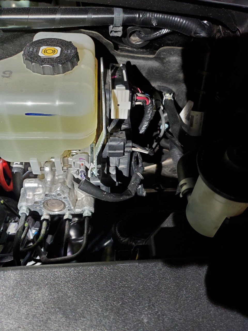

    lostMarbles
    lostMarbles [OP] A Lost Cause
    Oct 20, 2021
    #380086
    417
    Micah
    Alaska
    2021 3.5L 6MT, and 1997 2.7L 5MT
    The wingnut behind the wheel
    Thank you for getting my brain working. I looked at all the computer stuff and had no clue where to start.
    I don't have ABS due to A-TRAC in the Off Road, but it of course has a similar system connected to the reservoir. I walked through and disconnected the three harness I saw going to it (only one at a time, not all three at once). This did not result in a change. You can see all three in this picture. I'm guessing this indicates that this part of the system is not the problem.
    I then pulled the relay (which I should have done this moreing to save the drain on the battery). This of course stopped it, but does not tell me much as to why the circuit was closed. I'm having a beer and letting the relay thaw. I will try poping it back in before going to bed. If it does not flash with the relay being warm I know that is the issue. If it still flashes, well my theory on a frosen relay is probably bunk.
    As a side not, all of Toyotas wire harness connectors remain flexible at -26 F. Makes me happy as I was worried about breaking plastic parts messing with frozen connectors.
    DAS Taco likes this.
