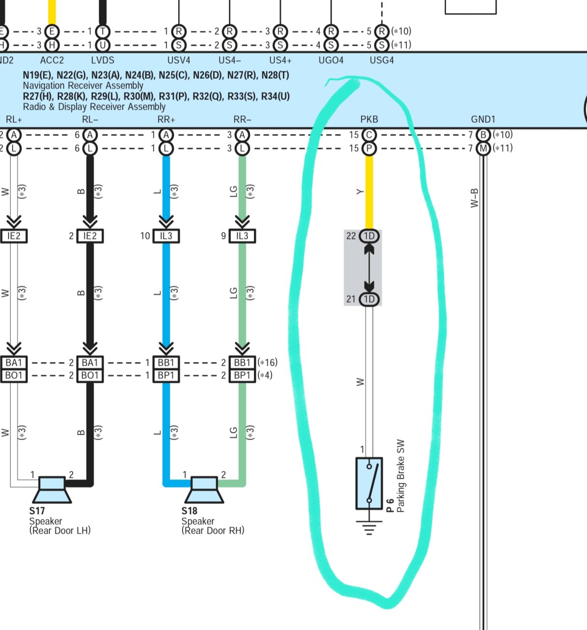

    The park brake doesn't activate the brake lamps in normal operation! How does it suddenly activate them with a temperature based pulse when cold?
    Just out of curiosity I just checked my truck with the park brake applied, and running. No brake lights....
    ktbell444 likes this.
  6. Dec 16, 2021 at 3:01 PM
    #46
    ktbell444
    ktbell444 One who throws exceptions
    Aug 8, 2017
    #226306
    2,969
    ᚺᛖᛚᚺᛖᛁᛗ
    Parking brake does not affect brake lights.
    Speedfreak likes this.

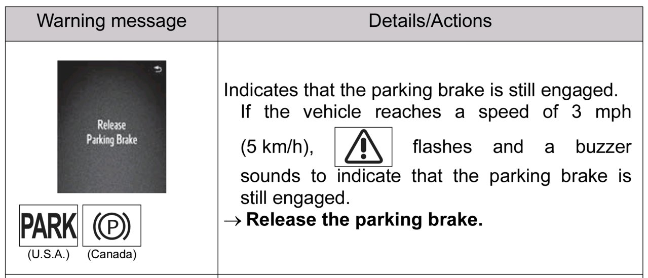

    If the parking brake was engaged while driving, the only thing that will happen is this:
    Regarding the tune, I don't believe that to be the culprit as it only makes changes to the ECM.
    I know you have already looked at the stop switch, but this time take some resistance measurements. I have attached the documentation to this post.
