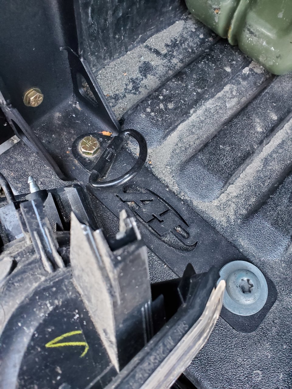

    To anyone removing taillights in the cold, the housings get brital. The two lower plastic tabs that hold the metal clip for for the retaining screw both shattered and allowed the clip to free spin.
    The actual wiring connectors remain nice and flexible though.
