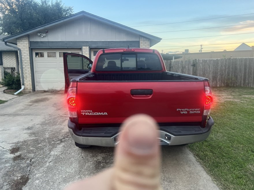

    Here are some pictures, this is with the full headlights on, Second one is brake depressed other is not.

    The photos confirm the problem but we still need to know if it’s
    When running lamps are on or if it’s only when you go all the way to headlights.
