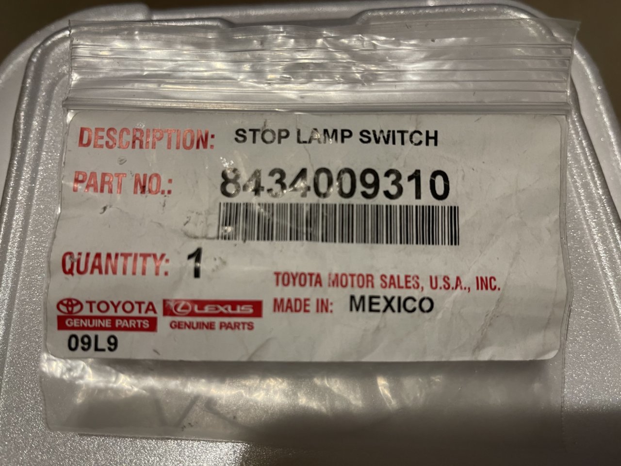

    Thanks. After work today I went to hook up the obd, the brake lights were on again, not sure how long. Obd said no codes. Connected the charger, pulled the brake pedal switch out. It has 2 big and 2 small male spades. The 2 big ones test normal, good. The 2 little one failed miserably. Time for a new one.
    Thanks. Hopefully replacing my stuck brake switch will solve the no acceleration issue.

    To follow up, after finding the brake lights on again after work, I unplugged the stop lamp switch and hooked up the battery charger. Got my hands on a new switch, stuck it in, problem solved.
    I should note the new switch looks different, blue instead of white, and includes a brown collar the switch snaps into, I used my old one.
    The associated no acceleration issue might have been caused by the ecu seeing brake applied. The short drive to get my morning red eye coffee was normal without the no acceleration problem.
