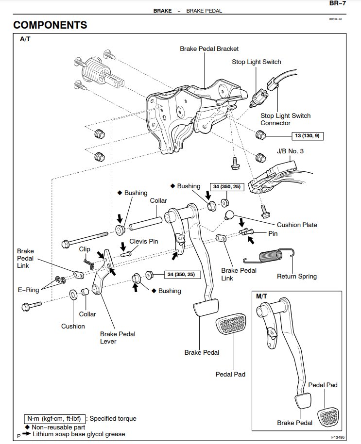

    Probably the cushion that depresses the brake switch has disintegrated.
    Labeled Cushion Plate in the diagram below, Toyota P/N should be 90541-06036

    2nd the "cushion" - it was a $1.80 at the dealer took like 30 seconds to install. Had exact same symptoms.
