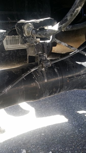

    My rear bilsteins (5160) came with a brake line block extension thingy took a bit of stress off the rear line. Not sure where to get one or if your were missing it20170317_101751.jpg

    There's the bracket "spacer" that Brich999 posted above that comes with the bilstein 5160s. Honestly if you think that is all you need, I'd just email or call Bilstein and ask them how you can get one separate. They're pretty responsive in my experience, usually emailing back by the next day.
    It's just a metal block (not even an inch tall?) that you unbolt the existing brake line attachment, slide the block under it, then a longer bolt reattaches to the axle housing. Can't recall there was much more to it than that...
