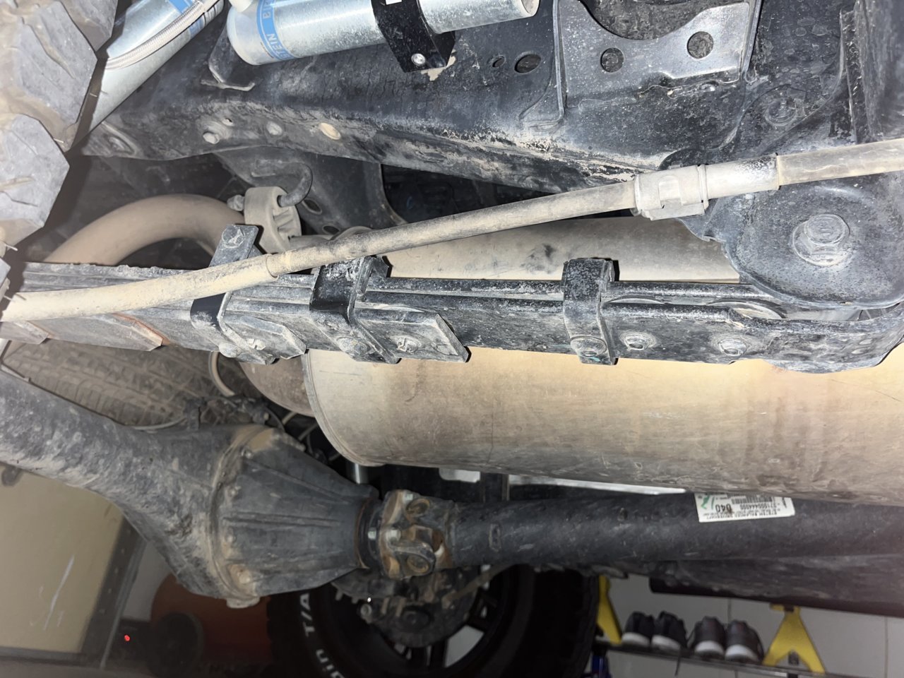

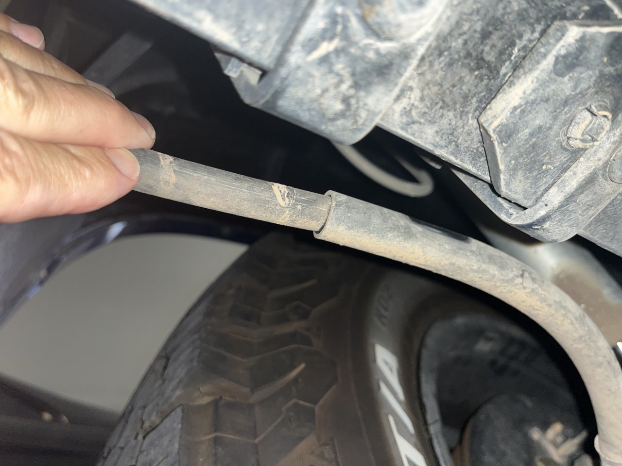

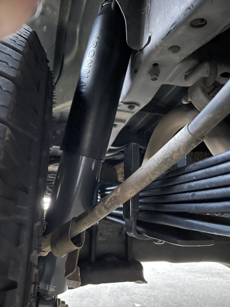

    I though, after 45,223 something miles and many trips out in the desert I better take a look at this free hanging parking brake line. So I took a couple photos while I was under there. Not saying everyone's results will be the same. I think the Wheeler's 3 leaf add a leaf with the factory overload removed raised the rear 1-1 1/5 inches.

    After inspecting the photos above, I do see a slight rub spot where it contacts the leaf spring clamp. I zip tied the factory bracket close to the original location after I first installed the add a leaf kit. Luckily I used a small cheap zip tie and it broke loose on my first desert trail test run. there is another factory clamp holding he line that is still in place only about 12-14 inches in front of the one I removed.
