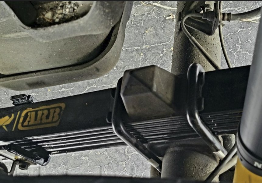

    For parking brake cables, the bracket near the front leaf hanger can be opened up and slid along the cable to give a bit more slack downstream. The hoop bracket mounted on the stock leaf pack clip can have its anti-rotation tab snipped off and be mounted to the OME pack's retainer bolt. Bend the hoop angle to suit the cable's new routing.

    thank you Sir! looks like the got they got the ebrake line on the spring retainer but ill look into that slack trick you mentioned
