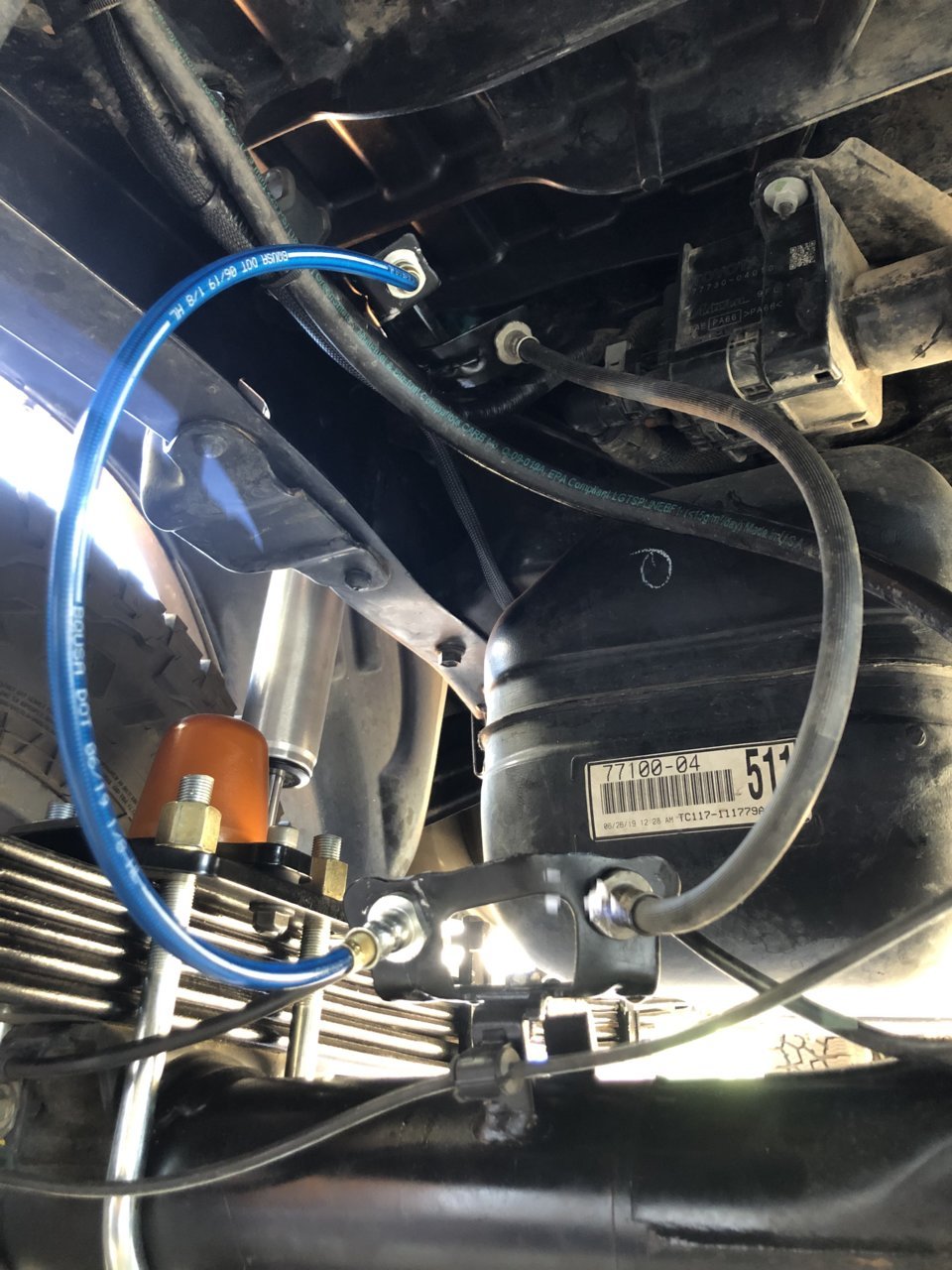

    Hi everyone,
    I got 3 out of the 4 brake line retainers out, but the one on the left here (upper) appears as if I can’t get any leverage to get it out:
    I sprayed Pb blaster on it and backed the 10 mm flare nut out about a quarter turn and it did nothing to help my case. I can’t get anything to the left or right of the clip to push, and I can’t fit pliers onto the lip to pull straight out because the bed is in the way. Anyone have any advice? Maybe if I take the flare nut completely off it’ll be easier? I have a long bed and I noticed my setup is slightly different than the short beds regarding accessibility.

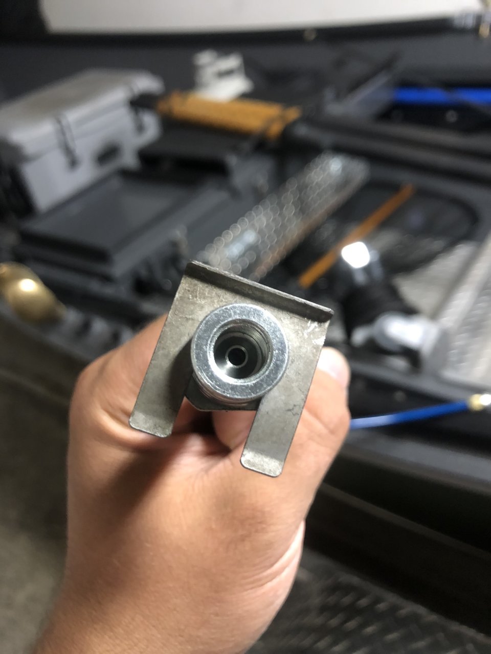

    The side you see is the female. You can only see the line that’s being replaced. On the top side there’s a retaining clip that’s holding the female in place so the hard brake line (10 mm flat nut) can connect to it. Looks like this on top:
    Yep! Went to Lowe’s just to get a set. It was the only way I could grip the top and wiggle it loose.
