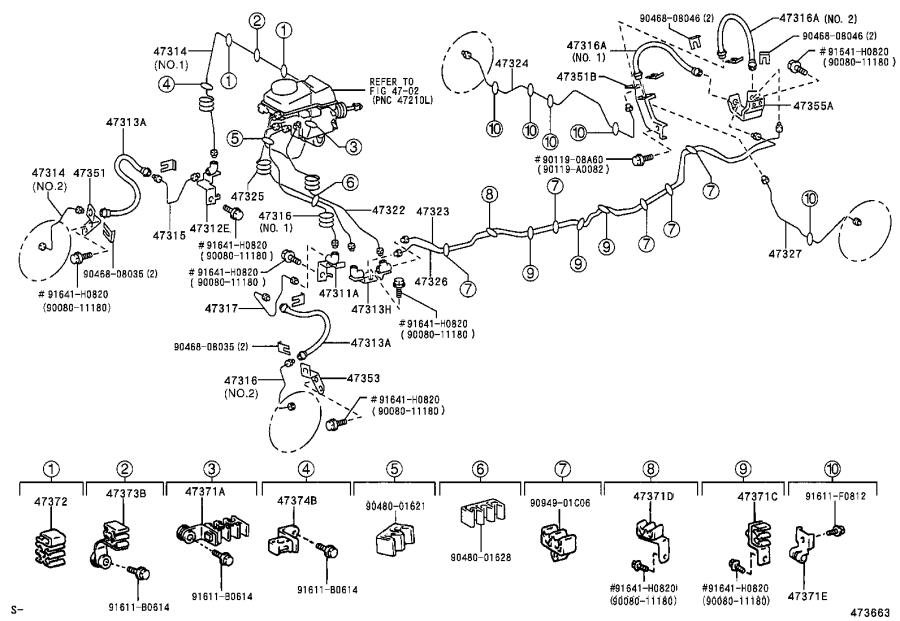

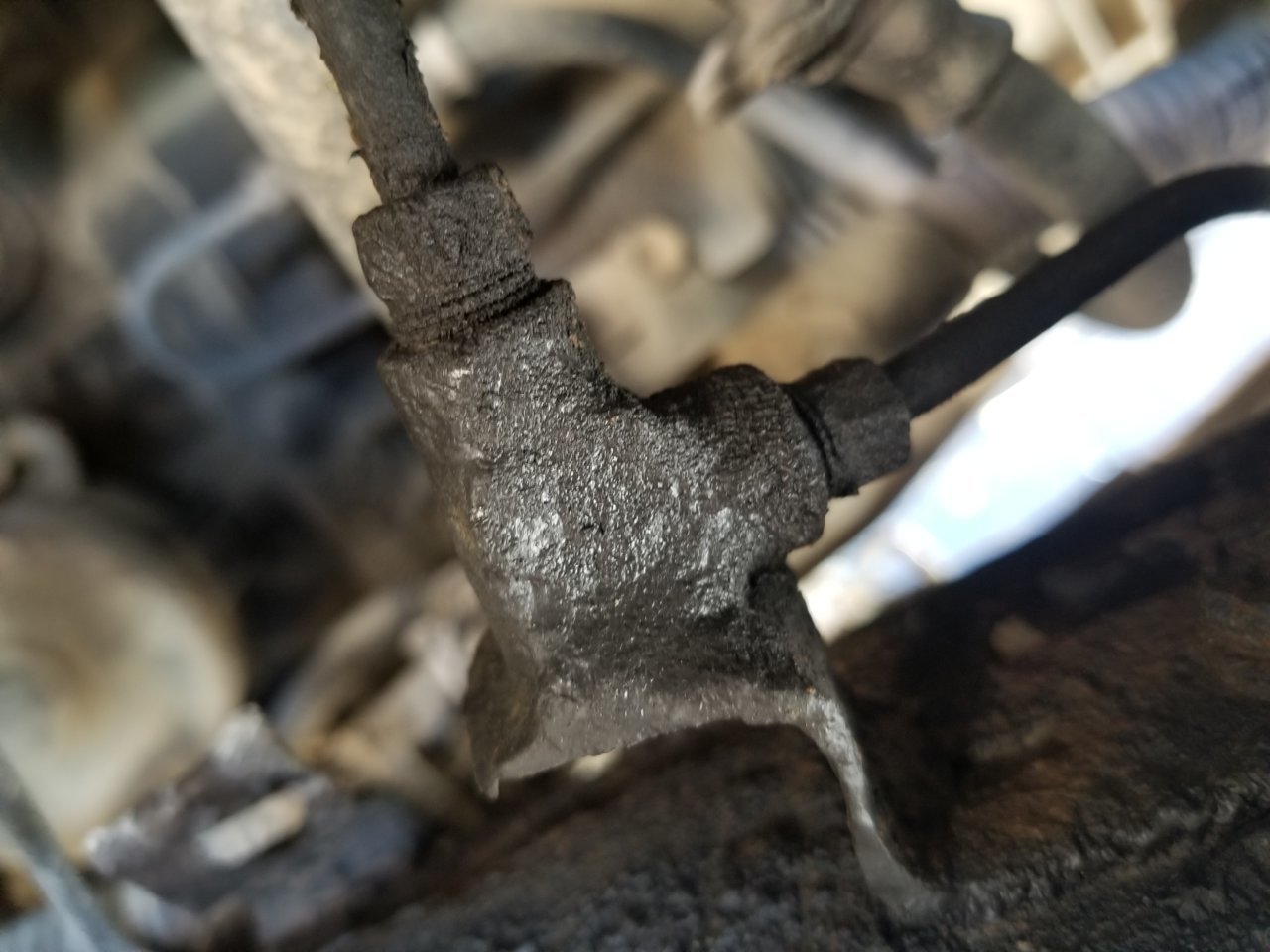

    Anybody have a part number Toyota or aftermarket for this brake line l bracket?
    The oil is kroil, not leaking brake fluid.
    The mechanic says I have to get tis part before he will do the work.
    Back story:
    I did the tundra big brake upgrade.
    I ordered the stainless steel lines from wheelers but I could not get the steel brakes free from the old brake hose. Even with soaking it in kroil 4 days every day prior, even with vice grips.
    So I tried drilling the old banjo bolt to use the old brake line but that failed
    It just sprayed brake fluid everywhere.
    So I had to bite the bullet and take it to a mechanic. Now that I started the project most mechanics would not touch it. (I did not tell this it was tundra just new calipers) they say thir parts or nothing.
    Soni found a mechanic to do it $100 per hr but he said I have to find this part for him first.
    I have searched several Toyota parts pages and found just about everything but that.
    I much appreciate you help.

    If somebody else runs into this same problem I finally found this!
    https://parts.maitatoyota.com/a/Toy...6912/BRAKE-TUBE--CLAMP/674460-4708.html#47311
    front Passenger side L fitting/bracket Part number 9090412029
    front Passenger side steel brake tube from the L fitting to the flex line, part number 4731504060
    front Drivers side L fitting/bracket Part number 9090412030
    front Drivers side Steel brake tube from the L bracket to the flex line, Part number 4731704020
    Double L bracket 909014004
