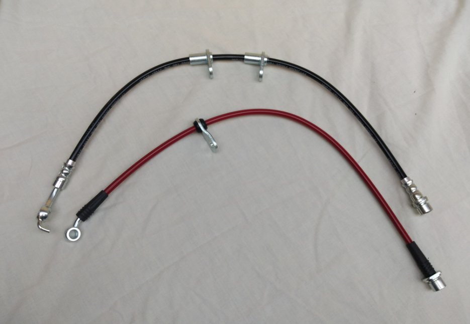

    I received the Wheelers stainless lines (in red) today. They have the correct mounting bracket for the knuckle. They look ok to me.
    In comparing them to the 1st gen lines from LCE, I can't understand why LCE has two mounting brackets. There is no place to mount the second bracket on a 6-lug.
    Has anyone else had this experience with a 6-lug?

    I replaced my ‘03 front brake lines with the Wheeler SS lines. Just the one bracket is required.
    I’m like you, not sure why the two brackets.

    My 5 lug has 2 brackets. Did they send the correct hose?

    I have the LCE lines and mine only have one mounting tab.

    I called and tried to explain the issue and they said the lines are for a 6 lug. But that can't be right.

    Im guessing its for if you have a stupid high lift.
    The lines work fine for a normal lift.
    The 2nd bracket it for if you have a "full retard" lift.

    I think you may be on to something here. I have the shorter lines for up to 3" lift. I think they make longer lines too so maybe that is what he got.

    I've heard about this strangeness from LCE on front brake lines as well. My understanding is that the multiple brackets are for different applications. I've heard 5- vs. 6-lug, and also for trucks other than Tacoma. Essentially, I think it's just their way of having a single line that they can use for multiple applications.
    Kinda strange if you ask me, but I guess it could be easier to inventory.
    Anyway, TL;DR - just use the single bracket and you should be fine.

    I think having a one design for all application is it. In looking at the site, they all have the 2nd bracket for a 6-lug. I ordered before I had taken it apart. I just shouldn't have ordered anything.
    I'll just stay with a single bracket line.
