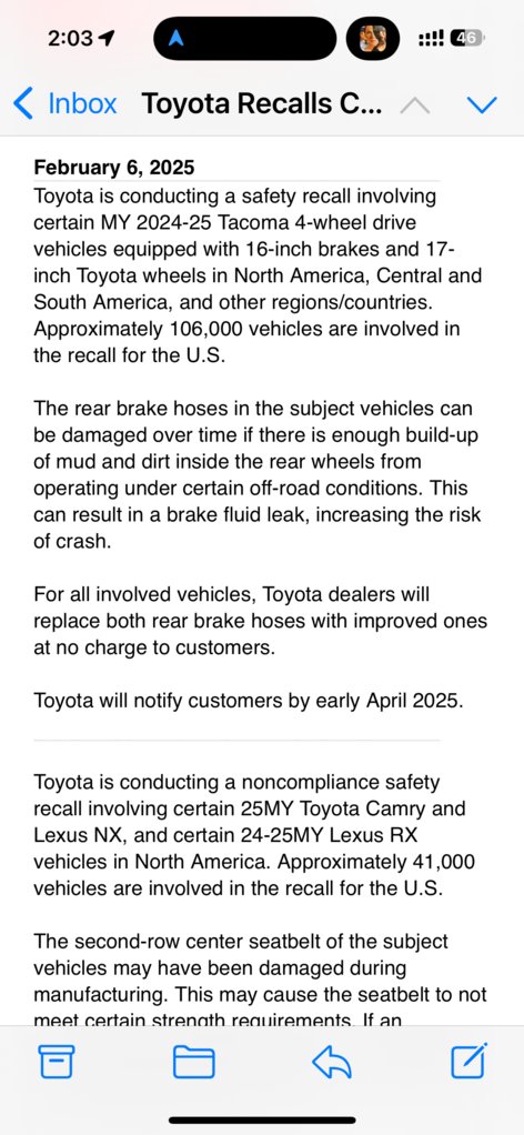

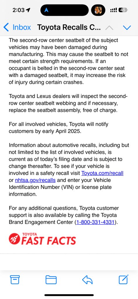

    IMG_0559.png IMG_0558.png Anyone else see this?

    Did Toyota just build trucks this way until yesterday? Have they changed the design?
  5. Feb 6, 2025 at 11:50 AM
    545
    545 Well-Known Member
    Mar 21, 2019
    #287482
    1,160
    2015 Access Cab
    Rear brakes are a totally new design for 2024

    Seems odd that they didn't include the rest of them. One wouldn't think the extra 1/2" would really "solve" the issue for the ones with the bigger wheels.

    So the Limited, TH, and Pro with 18" wheels are OK because they have an extra half-inch of clearance?
    Do all hybrids have 18" wheels too?
    Or maybe those have braided lines to start with (I suppose that's all they're going to do)

    So... if we change wheels from 18" to 17" we are going to have a problem and not be covered. Thanks Toyota.

    1st reported issue here was back in July. I'm wondering when and if Toyota changed production to address the issue on trucks coming out of the factory. Presuming a truck built today would not be subject to the recall.
    Edit
    I'm guessing the fix hasn't been announced yet?

    No "remedy" listed, does this mean they don't know what to do to fix it?
