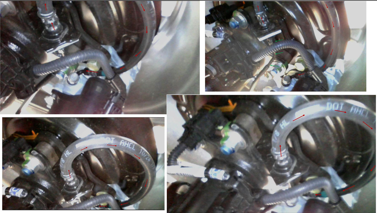

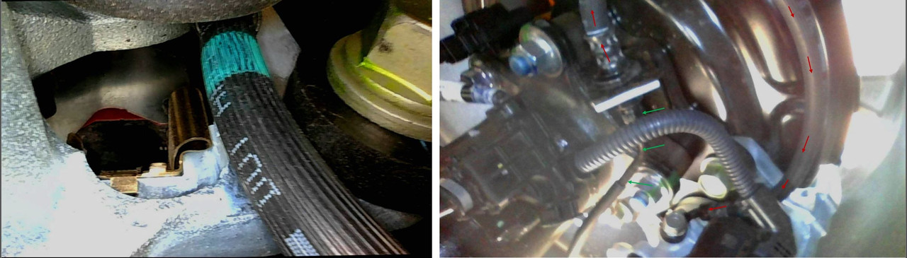

    Pics of "the fix" for the rear brake line, below. These are from a 2025 TRD Off Road with standard 17" wheels that was available for sale (this is why I presume this is a fixed truck). Apologies for the crappy focus on most of these.
    Below, on the left, I show this first, to point out the green band on the soft brake line (this is where the soft line attaches to the caliper port). I don't think this was on the original line so maybe they added the green band to the line so a tech can quickly see if the fix has been applied. Below right show the coupler/bracket where the hard and soft lines are joined (green arrows for hard line, red arrows for soft line).
    Below: I couldn't get a pic of the full routing so the below group of 4 shows a few angles that cover the whole line. Note the bend radius of the line is now down to be about the same as the circumference of the rotor shield (or whatever that part is called). Again look for the green stripe to get your bearings (it's hidden by the corrugated line in the upper right and lower left pics but visible in the others).

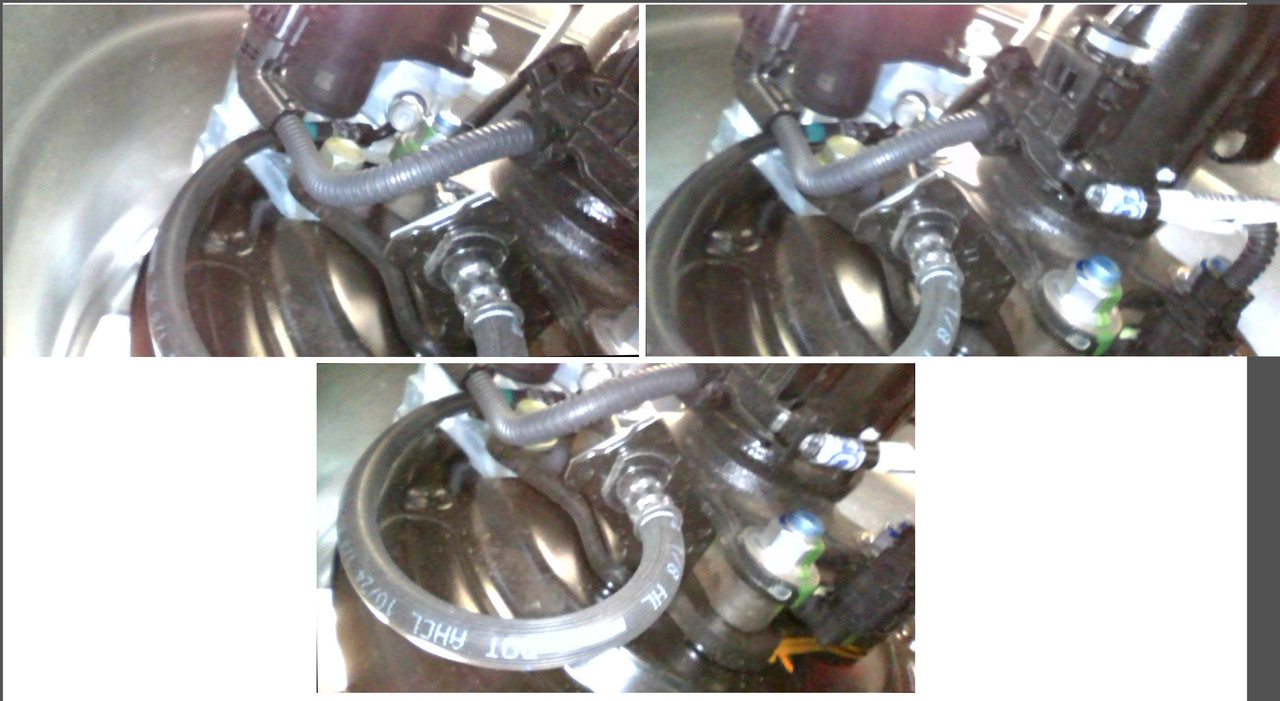

    And the next group of pics gives a better perspective relative to the inner wheel barrel, and how much clearance there is now.
    It's not clear to me if there is a new bracket that gets installed at different angle, or if they simply shortened the original line but all else was unchanged.

    Amazing you were able to share this. Thank you. Wonder if hybrid owners can also do this either through a future recall or by election with Toyota.

    Hard to tell from the pics, but it appears all they did was shorten line. Ok fix as long it's away from the inside of the wheel.
