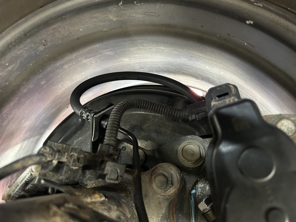

    Went in for my 20k service a couple of days ago. Service writer said they could take care of the recall at the same time. Here’s the result:

    So they just shortened the loop?
  18. Jul 20, 2025 at 3:04 PM
    #478
    tactrac
    tactrac Well-Known Member
    Aug 12, 2024
    #454994
    110
    2024 TRD Off-Road
    Looks like that is the case.

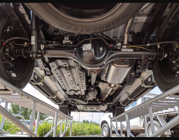

    I've been wanting to look under the F-150 to see how the lines are ran on there but haven't done so. This is a picture from 6G Ranger, looks like the soft lines run underneath the leaf spring from the axle to the caliper.
    Edit just noticed that isn't a US spec truck
