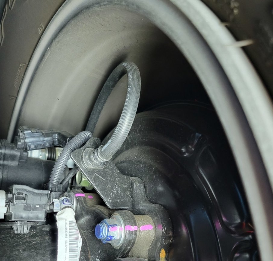

    I’m still not 100% sure than just 1/2” of clearance on a cheap rubber hose will be enough in the long run if you actually go off-roading… @ROBMOTIVE YouTube channel did a great video showing this…

    If you live or travel where it snows the buildup inside your rims will potentially damage that line.

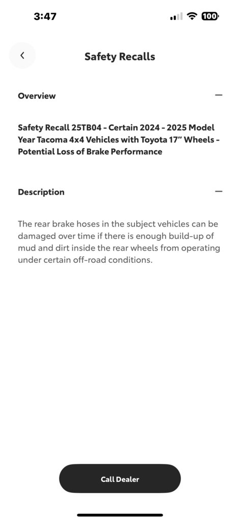

    So I got this recall notice via the toyota app for my SR5. It has dealer installed 18” wheels but my dealer told me when there is a fix they will do the recall on my truck anyways.

    It doesn't matter where you drive. It's a piss poor design destine for failure. You can even pinch the brake line just by remounting your wheel.

    I’m surprised this hasn’t happened yet because if you don’t line up the studs, you can drop the whole wheel onto the exposed brake line.
