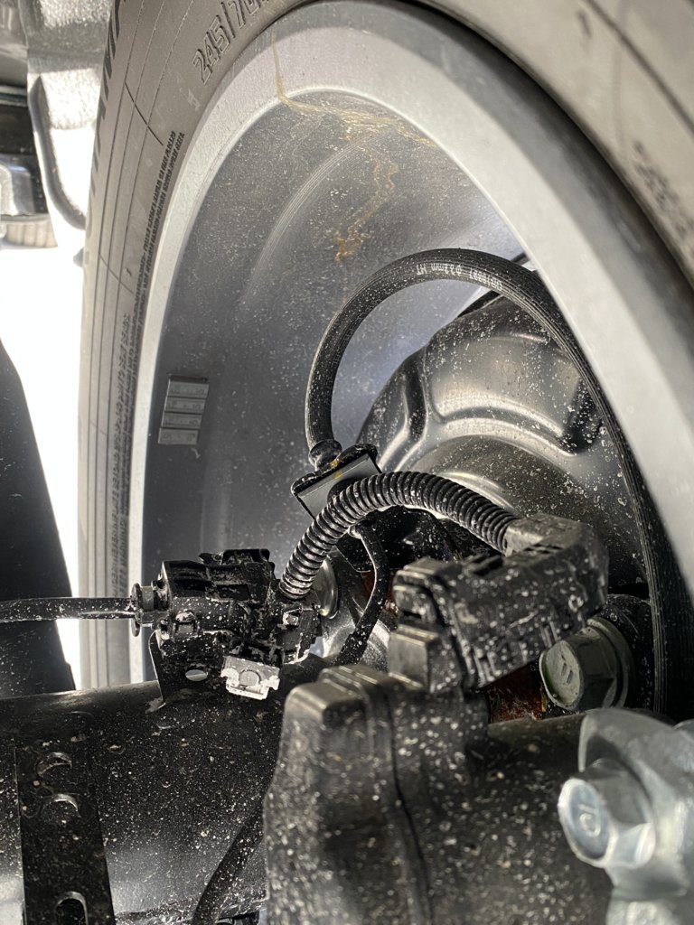

    I also would like to see how "the routing of the rear soft brake line is much different from the pictures in this thread" posted by @OldSkoolArcher.

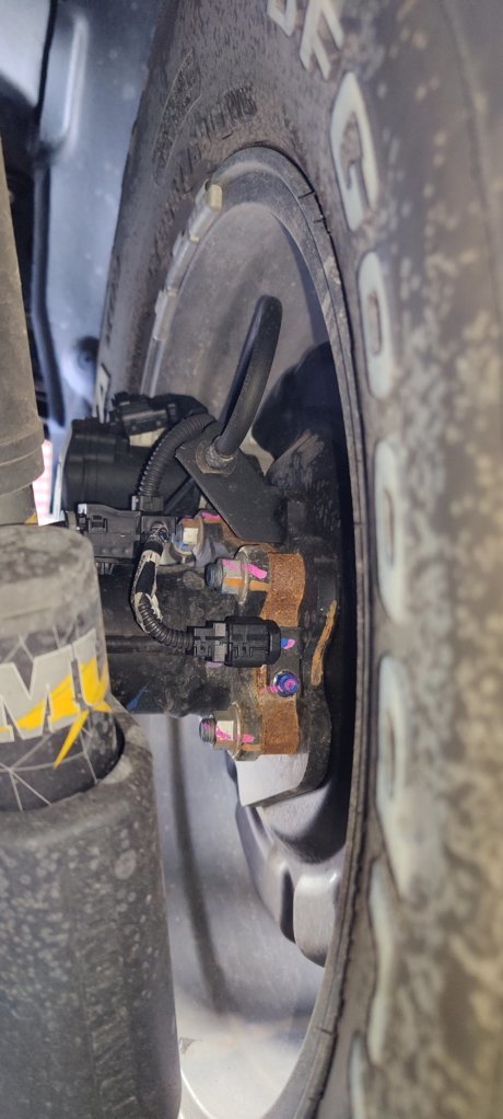

    Apr 10, 2021
    #362304
    1,218
    I don’t think this one can be pinned on Sheldon, unless he was also involved in the design of the 4runners, and LC250s. They all have that same wrap around routing. They also do the same thing with the electrical wire that goes to the parking brake actuator. The first time I noticed this was on the first Tacoma videos where it seemed Toyota was showing off pre-production units. I figured it was a prototype thing that would be finalized before production.
    It boggles the mind how nobody bothered to design a proper routing that positively clears other rotating things. Not to mention the snag risks.
    These connections are not even acceptable risks for mall crawlers or road cars.

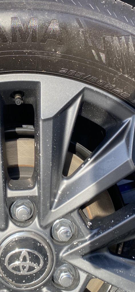

    McSpazatron
    McSpazatron Well-Known Member
    Apr 10, 2021
    #362304
    1,218
    I have no idea if Toyota is going to recall LC250s or 4runners. I was just saying that it seems all Landoma Cruise Runners share the same hose routings.
    Local dealer had a bunch of LC 1958s and I snapped some pictures a few days ago. This one was on 20s, so it was easy to spot the brake line walking up to it.
    I wanna say I looked at the 4runner they had there and it was the same, but I don’t seem to have pictures. Shouldn’t be hard to verify by anybody stopping by a dealer.
